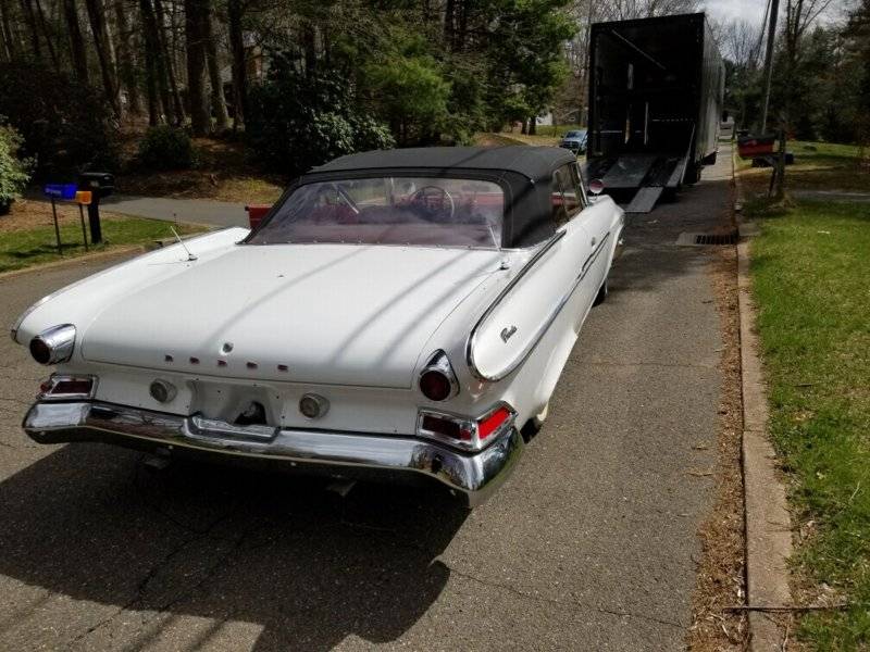

New here. I just purchased a 1961 Dodge Dart Phoenix convertible. It’s on its way from the east coast to northern Cali . My first of many questions to come is tire and wheel combos. I did not see anything posted in the past to cover my question . Going to do 17 inch rims. What’s the biggest size tire and wheel I can run? Backspacing ? Thx
