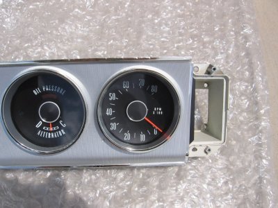

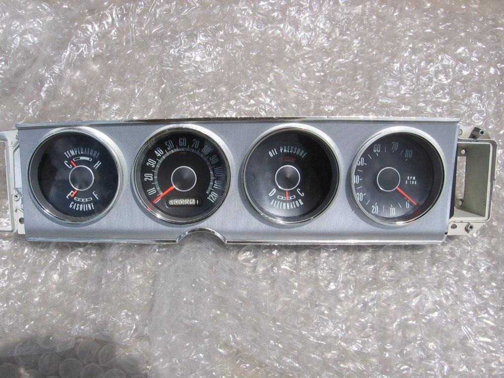

I removed the clock in my 64 and put a mopar repo tack in it's place fits perfect, I think 64 only.

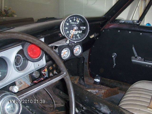

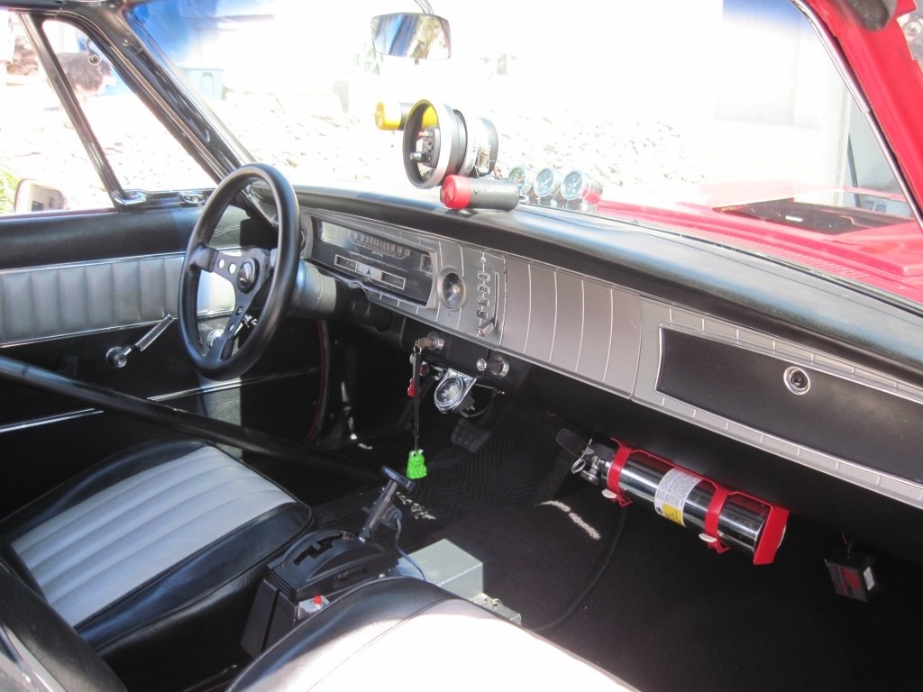

64 Dodge. I hung the Sun Super under the top of dash lip. Blocks where the clock would be, but I don't have one . Back against the chrome trim with the bracket, but no interference with steering wheel or 4 speed shifter knob...........................MO

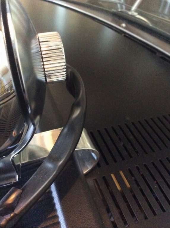

Its not bolted through the dash it just slides under the dash pad, I bought it on the A-Bodie site last year from a guy who made them and not sure he's still offering them

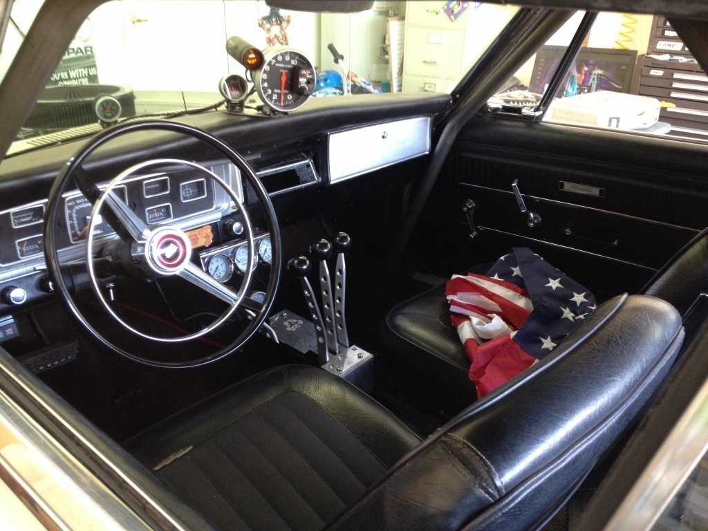

Moparcrazy, educate me on that shifter setup. Reminds me of a lenco trans but you running an automatic.
"its a really cool set~up" most people think its a lenco but its just a Shifter like B&M custom made by a Irish guy here in California, his company is Kill Duff shifters

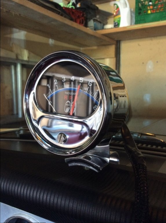

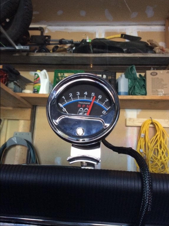

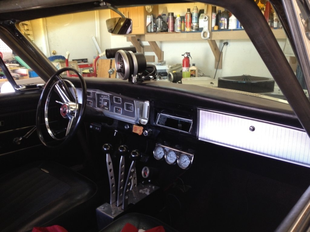

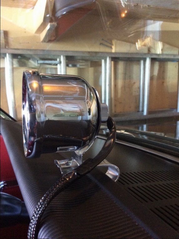

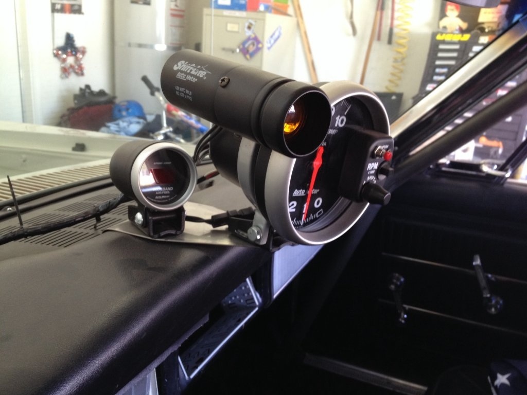

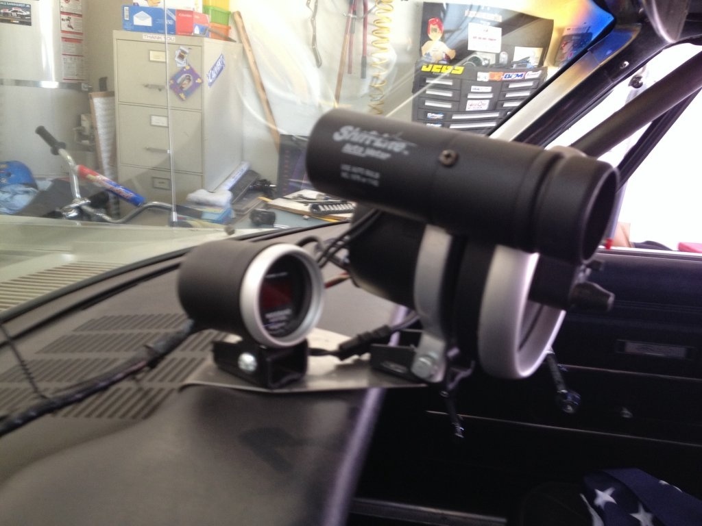

This took a little longer then usual due to some unforeseen no brakes issues. Gotta love single master cylinders giving out while on a cruise down town! Anyways I managed to make a curved aluminum bracket to mount the tach which slipped under the dash pad. Here are some pics.
Why do you need a tach?
I don't have time to look at one when racing and ran 3 back to back passes that were identical 3 weeks ago with a fwd.manual valve body.
Ain't nobody got time for a tach! :D

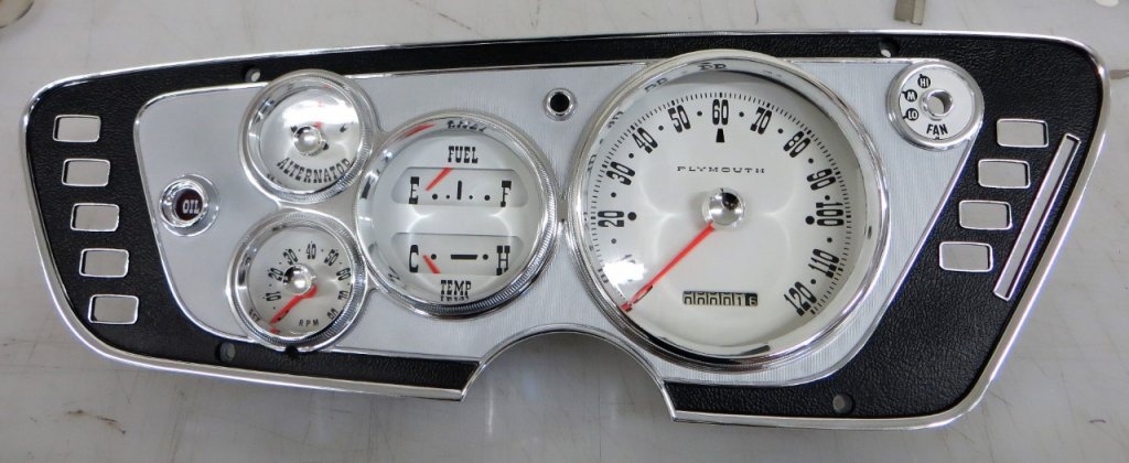

like above^^^ Redline Gauge works did my 64 Belvedere dash with a factory looking Tach.Sorry, not the best photos.
