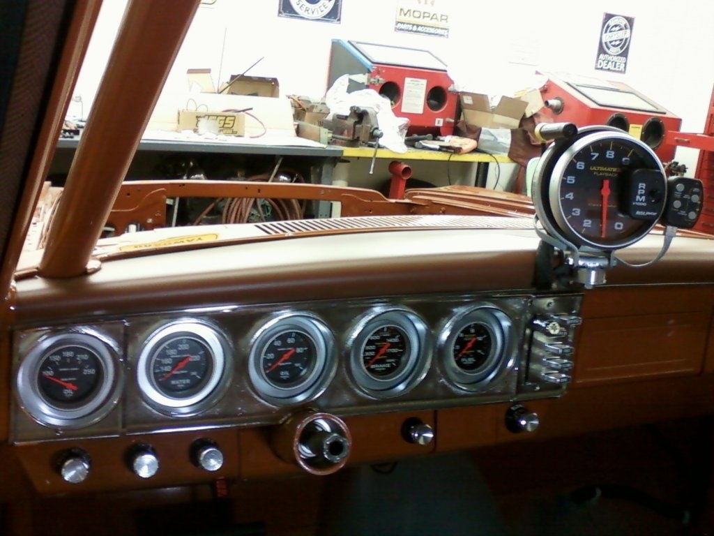

View attachment 359451Had Redline replace my clock with a tach, G-Car did the bezel work![]()

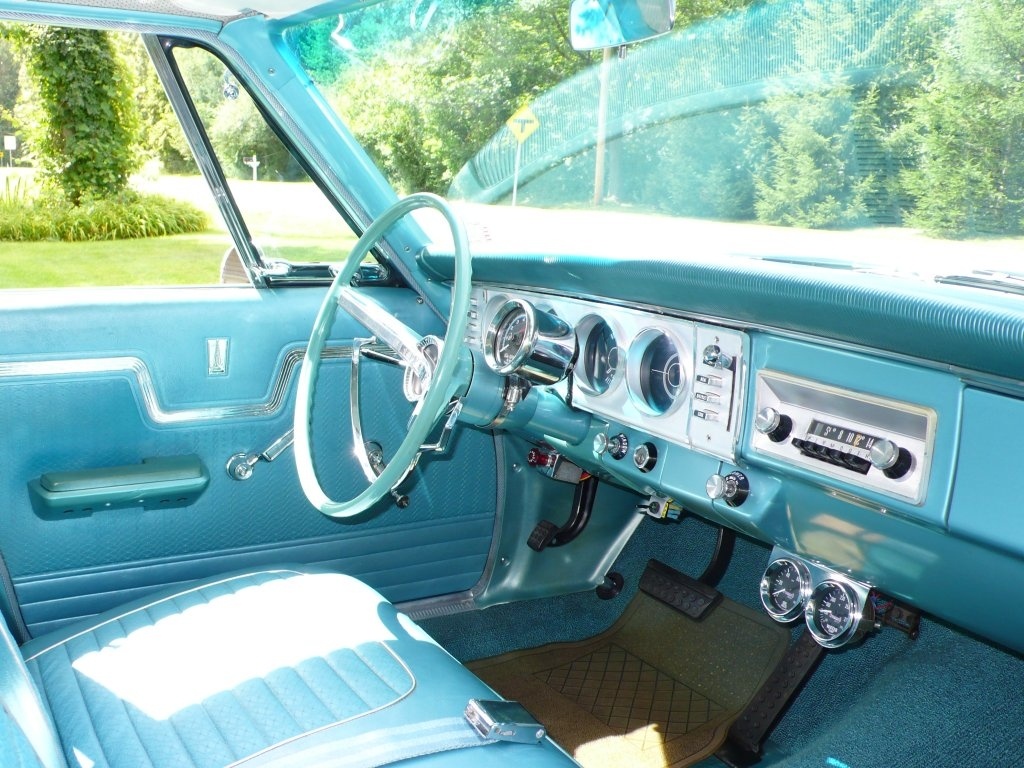

Some holes are UNresistableHoles were already in the dash. I made a mount and a backing plate for under the dash. Not much room to place it anywhere else, maybe under the dash.

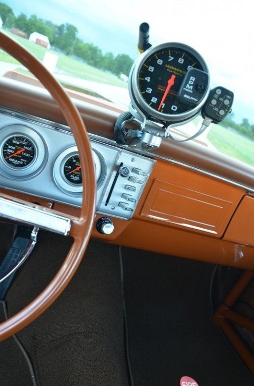

Lots of differences between 62/63 and 64/65. That being said if you going to race it and its quick you need to have it in the line of sight as 2nd comes up quick. I didn't want holes in the top of the dash though. So I fabbed this up. completely adjustable.

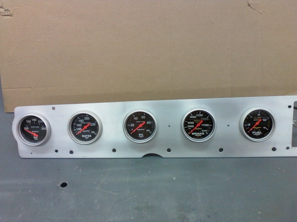

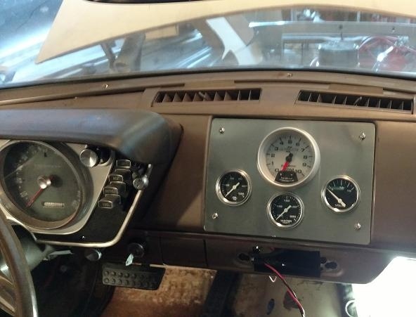

And the rest of the car, for that fact. I haven't seen it in awhile. I'm just crazy about that color!DVW, can you post pictures of your entire instrument cluster? It looks like you did something custom with the whole cluster.
Thanks!
Flat aluminum panel replaces the stock cating. A shift delete plate was cut out and filled with a ring from a spare bezel creating a space for the 5th gauge. Shifter was moved to the right side of the dash for cage clearance. Shifter bezel was fabled from the inner portion of the shift bezel and the outer portion of the heater bezel.DVW, can you post pictures of your entire instrument cluster? It looks like you did something custom with the whole cluster.

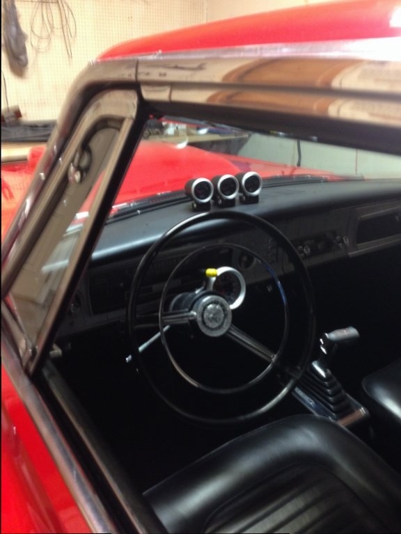

Mounted mine on the steering column.
