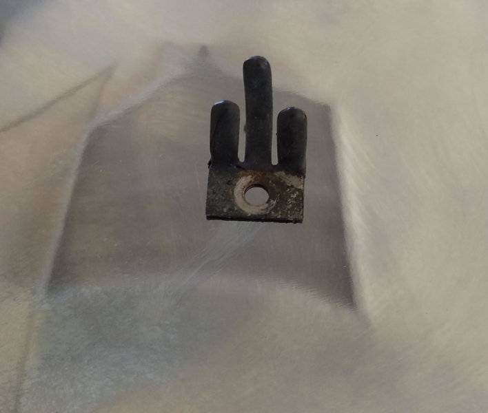

Hi All Mopar friends,
Can anyone tell me where this goes? I took my entire engine bay apart for repaint it. I have bagged and tagged everything but this last clip. Any ideas?

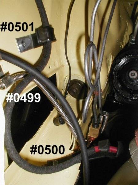

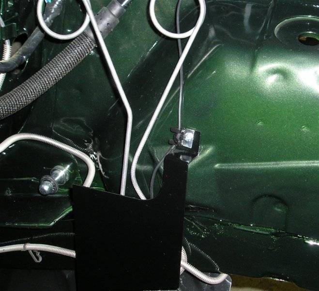

That clip holds the brake light wire on the inner fender well. Some cars they are in the position of the picture in the green car. If you do not have a hole there they go on top of the #501 bracket in the picture of the yellow car.....
what would they call that clip,mines missing.
