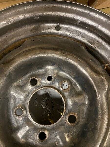

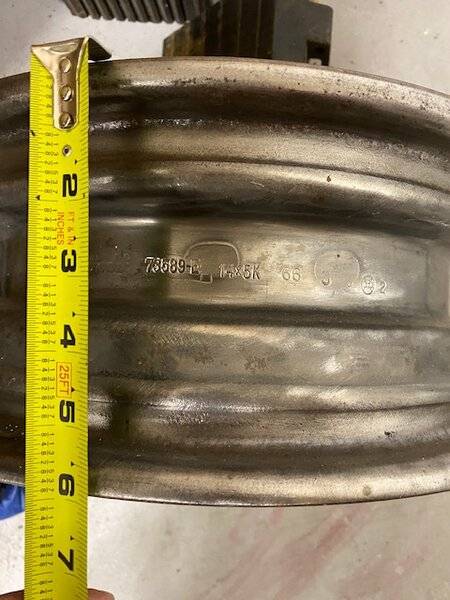

Here is one of the Original Wheels (at least I believe this to be an original wheel) that came on our 66 Coronet 500. It looks like they are14 by 5 inch?? Best, Brian
Brian - yeah, they do look like 5" wide. I guess the 5-1/2" wheels didn't get wide spread use until later than I was thinking.
