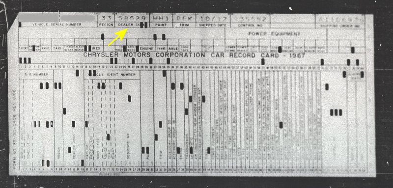

The IBM card is the document that, basically, started the process after the order was received from the dealer. The major production and administrative process started with the IBM card.
SOME scans of 1967 IBM cards are available from Chrysler Historical. It is worth checking to see if yours exists. Some are easy to read; some are not.
The dealer number is on the top line.
