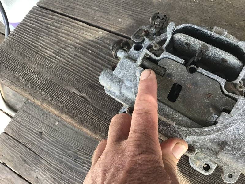

On the secondaries, on the AFB carb, your not moving a weight to a unblock a plate. And it’s not vacuum to open the plate ether.
The counter weight on the AFB door is to the side and unblocks nothing. The velocity of air from the mechanically opened secondary butterflies allows the air above it to move past the weighted air door, which is not sealed, to provide air pushing against it, opening it. Your confusing the operation with a Holley.
Carter has written about this. No Carter carb is a vacuum operated secondary carb.
Edelbrock still sells the kits to tune the carb.
Yes, you are right, thanks for correcting me! I still have my old AVS, just looked at it. It’s a spring loaded door. I misspoke about it being a vacuum secondary carb.
