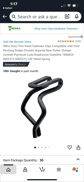

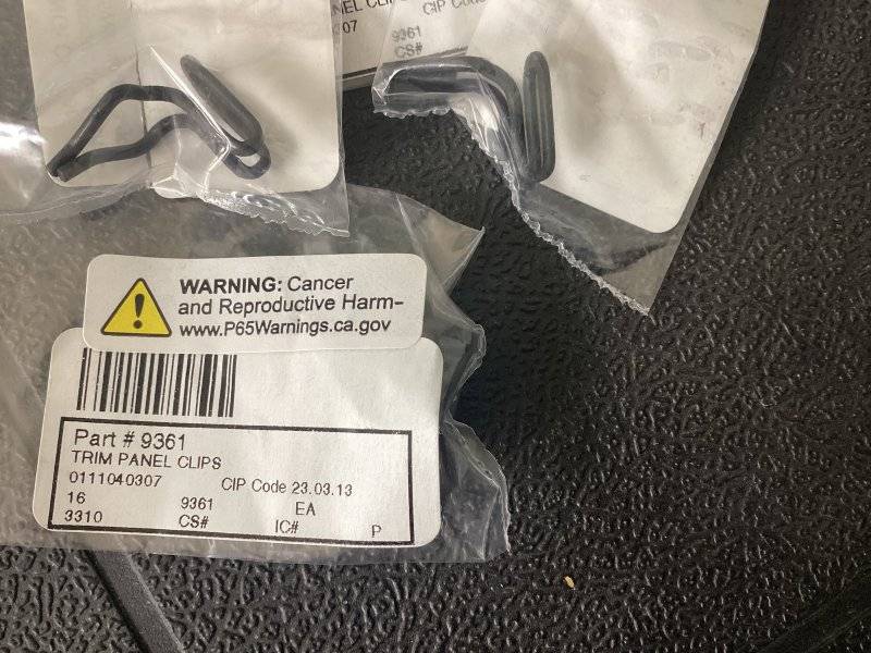

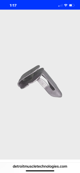

Getting closer to installing new legendary rear and door panels…. Can’t seem to get thru to Legendary..
I see there are 3 possibilities for rear panels and door panels…
First picture they come 7/8” or 1 1/8” overall length? Seems like the longer ones are too long for rear panels?
The second picture, I don’t know where that style clips go?
Funny thing is that I've pulled many Mopar panels over time and it seems like they are both used. I've found both clips used in various cars. Maybe it was a regional thing?

I just installed a bunch of these as replacements on my 68 Charger, worked great.
Are they the 7/8” overall height or the 1 1/8”?
Did you use these on both the door panels and the rear interior panels?
Thanks
Closer to 7/8, definitely not 1 1/8.
The specs are in Class.Ind description.
Yes used them on both interior door panels just last week.
Ok thanks….wasn’t sure if they were too long for the rear panels
I pulled those clips from several '70 Charger door panels and like others said, I've seen both, and no reason or rhyme as to which was used where.
The upper door pads, however, seemed to only use the 2-leg spring-style clips, from what I remember.

Ok, which are the “ 2-leg spring style clips”?
The upper pads are my concern if they’re too long
Do they not include instructions and the tool anymore ? Shame. I'd use the second picture, the way they say to install
Do you use the “second picture “ style on the rear panels, upper and lower, and door panels?
It doesn't really matter for the front & rear lower pads. I've seen both used. But for the hard upper door pads, I've only seen the 2-leg clips.
