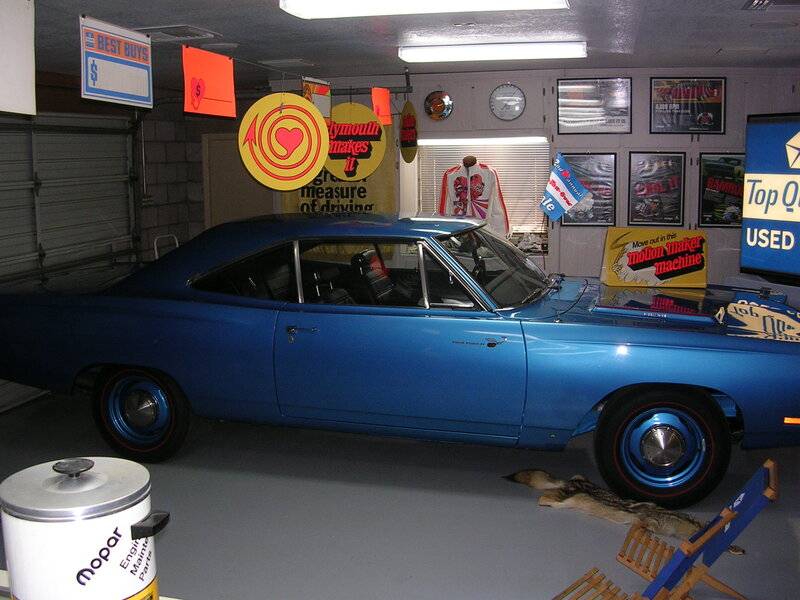

Those look great. Same Dog Dish hubs. What tire sizes. I think I am going 225 70 r15 s or 235s 7 inch rims.
Hemi cars had F70x15 on 15x6. Equivalent today is 215s. The Sixpack cars had G70x15 on 15x6 black wheels, 225s today, no matter body color. Your 383 would have had green 14"wheels and caps.
