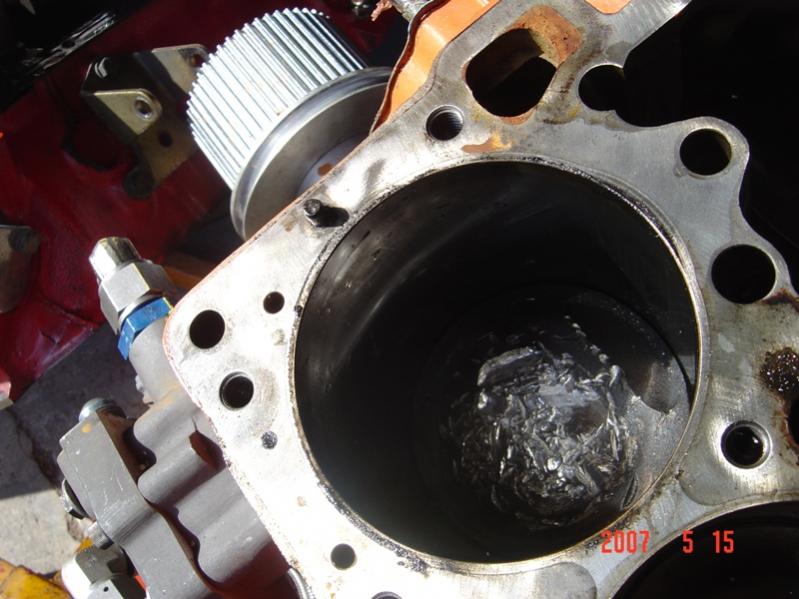

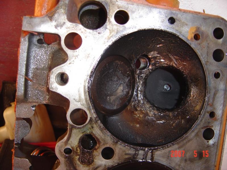

Hey, just talking from experence. Did you ever notice that when you break a valve in one cylinder it also take out about 4 or 5 other ones also.
You could check out Kofells work..... They're in Michigan too...
Kevin,your making WAY too much sence:headbang:
Now that's not something I hear every day. LOL...
Hey, just talking from experence. Did you ever notice that when you break a valve in one cylinder it also take out about 4 or 5 other ones also.[/QUOTE]
Yes,that when I learned the definition of "reversion":angry9:
Hemi-ItIs Ouch that looks very expensive, sorry to see your engine wreckage, did it wipe out the blower too, wow that could be some serious carnage...

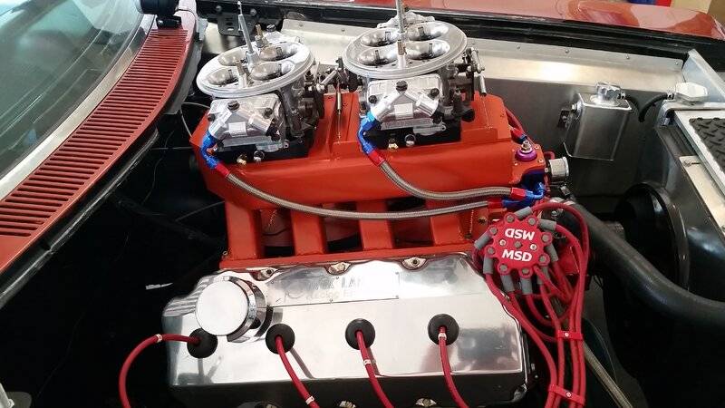

Wow, old post from the past. I have Mopar heads on my 528" reworked, big solid roller cam and RBRE rocker system. Street driven and doesn't do half bad at the track either. All of the brands mentioned are top of the line products. Can't go wrong with any of them. It comes down to cost, but anything with the word Hemi is never going to be cheap.

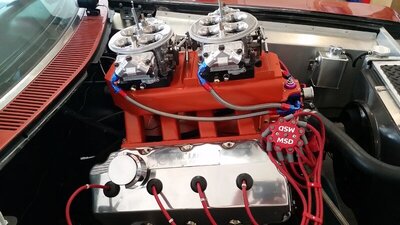

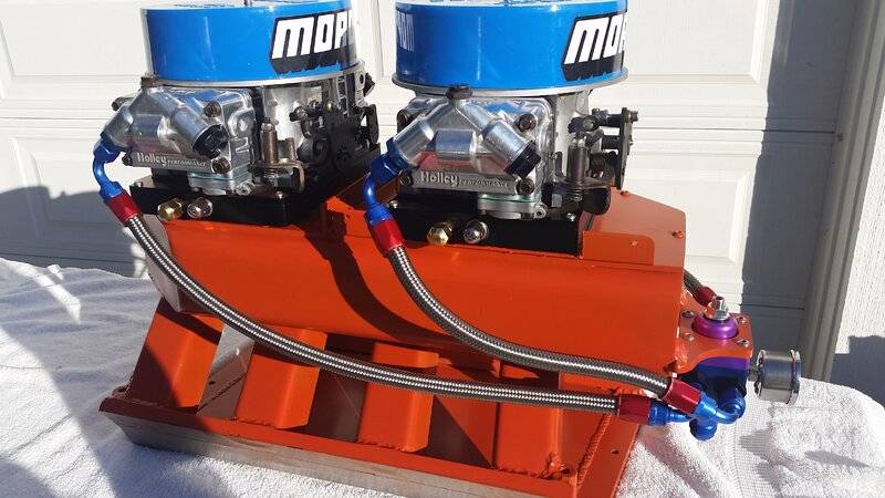

In regards to the Hansen Stage V Milleneum raised port heads...although they are absolutely the best HorsePower head (my Hemi makes 1011HP on the Dyno) they demand a very special intake manifold because of their raised port design. NO normal intake manifold, be it a dual quad, single plane (Edelbrock, Barton or Indy) or off the shelf Tunnel Ram (such as Hogan) will NOT bolt onto those heads as the 8 attaching bolts on each side of the intake manifold will NOT line up with the threaded holes in the head. For Hemis Only (FHO) in Canada makes an adapter plate to allow these Stage V Hansen Milleneum Heads to receive a normal intake manifold but then you lose the benefit of the raised ports. The 572 HEMI in my 64 Belvedere has Hansen Stage V raised port Millenium heads but the intake manifold on my motor was a hand fabricated aluminum Tunnel Ram produced by Dick Landy Industries. I tried to put on a regular INDY Single Plane when I had the Tunnel Ram off the motor (for normal motor servicing) but that manifold would just not fit...that is when I began the research on the raised port heads, etc, etc, and found out all this information.
