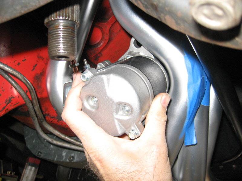

Autozone is a block from my shop so I use them often. I have their part numbers. DLG 17677 or a 17084N . The DLG 17677
is the one in the photo. The car is a 64 Belvedere 318 poly.
