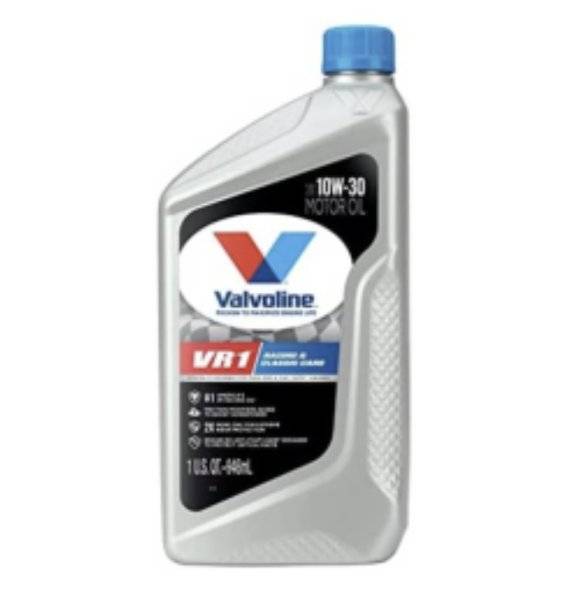

Picture is very blurry, hard to read. Is it Full Synthetic? Both the Penrite oils I use are full zinc protection but are mineral oils.
Oils seem to be a very personal subject where people have their favorites but I'm wondering why? Is it just a case of 'well I've always used this and had no failures so it must be good" or "my father always swore by it".
I'm open to using any oil, but I'm keen to know the reasoning behind people's choices.

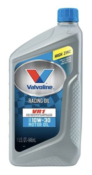

25w-70? Is that metric or something?
Here in the US we have lots to chose from. Personally I run 15w-40 diesel oil in anything with stock valve train. If I have high spring rates and want the assurance of high zinc it’s the VR-1 10w-30. I’ve used Brad Penn oils too for high zinc.
As far as I know they’re all dino juice.
Not the synthetic, mineral oil.

Valvoline VR1 Mineral 10W-30 or 20W-50 have high zinc 1,400 ppm
Valvoline VR1 Synthetic 10W-30 or 20W-50 have high zinc 1,400 ppm

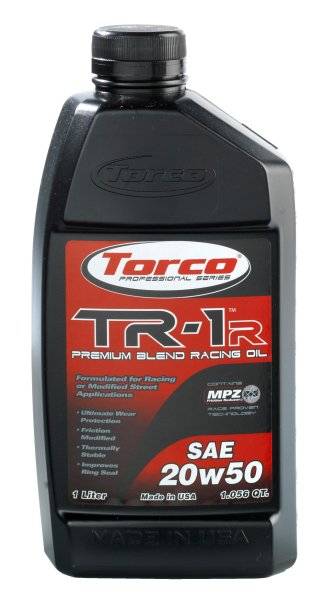

I have a buddy, fellow drag racer Doug B.
he used to do destructive oil testing on all brands, before he retired
at Richmond CRC, Chevron Research facilities after 40 years 'expert'
on his recommendations & testing
I run a high mileage or a Race Oil Torco Synthetic TR-1
10w-40 for cooler temp or 20w-50 for hotter temps
in all my special engines, viscosity usually to me
all depends on clearances
& what style of camshaft or rings (even bearings in some cases)
but still the same oils/brands
in my Daily Driver 99 Dakota SLT 4x4 5.2ltr/318 Magnum roller engine,
has 1.7:1 HS Rollers too, since doing that switch
I used 10w-40 Synthetic Royal Purple, since like 2007
in fact everything is Royal Purple synthetic 'that used/uses fluids on that truck'
so far so good, after nearly 16 years now...
allegedly
Amsoil & Redline full synthetics are the best for wear
in unbiased testing
I used to use both at different times of racing
Until I got my Torco sponsorship &
I never had any failures due to oil even in harshest of racing conditions
for over 25+ years I used their products
so I've stuck with them 'like the loyal dog I am'
for 35+ years now
Interesting. That seems like a really thick viscosity on the warm end. They must measure them differently or use a 250f thermostat.

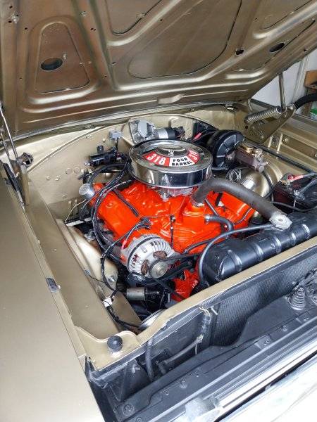

I was told by the engine builder to use a straight 30 weight in mine. ( basically stock street hemi with mild solid lifter cam/lifter pkg )
So it gets Rotella 30 with a bottle of Lucas ZDDP zinc additive at each oil change
