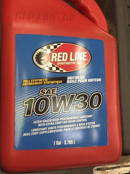

Some big name full syn oils did badly: Redline.

This is what the test report said on 5w-40 Redline:-
'This was the second most expensive oil on the test, so we expected it to perform - especially with the boasts from the manufacturer. Put simply, it didn't with the film breaking with 6lb on the lever & a scar length on the test bearing of 6mm. Its extreme pressure properties were not as good as some of the far less expensive oils..'

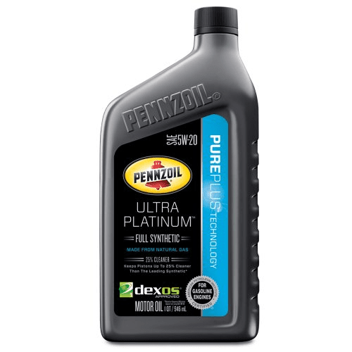

The only thing I'll add is that the LS motors were spec'd for Dexos1. Anti sludging properties I presume.
That is another new one to me, Dexos1. Is that a type of oil, a brand name or an additive?

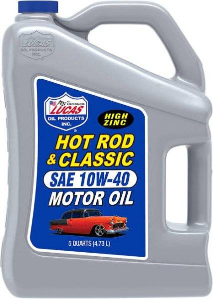

This works for me living in a temperate zone. It also comes in 20W-50.

One brand I stay clear of is Pennzoil. I just don't know how to interpret their products anymore, and back in the day when it was just Pennzoil without whatever flashy labels and branding on it my family used it basically 100% for vehicles(except farm truck). Mostly because both Grandparents had used it forever. So my Dad did too.
Then in the 80's, my Ma's Caprice wagon wore out a camshaft. Well that's what the repair guy said. Wore it out far enough it wouldn't run anymore. Replaced it and back in business(that car ran forever) Then we had a mid 90's Buick LeSabre. 3800, but it started getting loud at 140k miles. Younger brother drove that and the engine eventually gave up. There are a couple more examples(not all GM products) of weird wear with valvetrain on engines known to run for a longer time then we were getting. Other vehicles like my older Sister's had gotten oil changes at the corner shop out of town with other brands and had worn normally.
So sometime in the late 90's my Pa and I decided maybe it was the Pennzoil. The wear was all similar, and it seemed to be the only common thing. We reminisced about my Grandpas, but they both really only ever drove 45 MPH on the country roads up here and never pushed their cars. So it would seem old Pennzoil was really good for easy living cars in the cold up here, but when the vehicles were driven a bit more normally(or harder with a bunch of teen drivers in the house over the years) it didn't do so hot with warm engines and the valvetrain suffered. So I haven't ever bought it. And I don't even know what they offer because every time I see it there is a new color label with different lingo on it.
I was told horror stories about Quaker State in the 1980's. honestly never tried that one, the others I mentioned above are doing fine by me so I have no reason to.
Pennzoil and QS used to be the same company way back when before Shell purchased the company.
When my son was a teen he got a job at a quick lube place which used Pennzoil. He could tell which cars used Pennzoil exclusively. The insides were all filled up with deposits. Just pull the oil cap and look inside. Nothing but gunk.
That may be different now.
As for the Dexos 1/2 labeling, it's all a money making scam.
GM got this idea to require this new spec oil, but many oils already met the spec but the oil had to be tested for that spec. But to get the Dexos label you gotta pay GM for its use.
