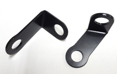

Reference the running of the brake lines, anyone know where to buy these tabs?
9BDACDC1-0A07-4929-A7C6-8B0FCF6FE880.jpeg 22522726-3BEB-4952-9B17-49FB07207B47.jpeg
