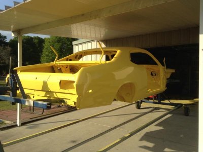

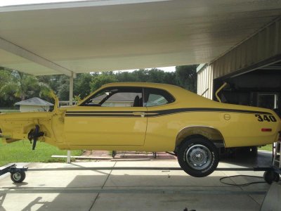

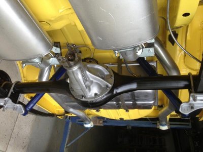

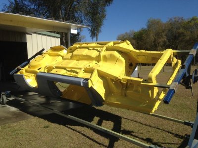

That is how I build my cars. These are pictures of my last restoration which was a 340 Duster.
Hope this helps you with your decision.

Thanks. I have already installed U S Car tool frame connecters,torque boxes, lower radiator supports, fenderstiffening supports, also welded & gusseted K member. And also while I was installing new froor pans & trunks pans I stitch welded everywhere. I have the rest of all the suspension & underbody parts still sitting in boxes waiting to install. I don't think Il do anything else to the underside. That badass yellow Duster is just what I needed to see. I think my mind is made up now.
