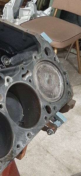

Pistons 155 in the hole with a .045 dish. Heads 90cc

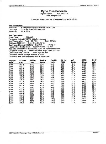

Here below is a much smaller Comp Cams XE274H 224*/230* @ 050, with .477"/.418" Lift used on a .030" over 440 @ just under 10:1 using checked/cleaned up E-Street Heads and a Holley SD Intake.
It can get by just fine.... and breaks in really easy at 110 Lbs seat and 280'ish open pressures using mushy Chebby .842" lifter ramps.
Notice it never drops below 520 Ft/Lbs and for most of the rpm range stays well above 513 Ft/Lbs all the way to over 5,000 rpm ?
THAT.... moves heavy cars...
Oh OK.... I've never seen a 'dish' 440 Piston ? Not say'in they aren't out there, just never had the pleasure I guess ?

Here is a much smaller Comp Cam XE274H 224*/230* @ .050 with .477"/.418" Lift used on a .030" over 440 @ just under 10:1 using checked/cleaned up E-Street Heads and a Holley SD Intake.
Notice it never drops below and stays well above 500 Ft/Lbs all the way to over 5,000 rpm ?
