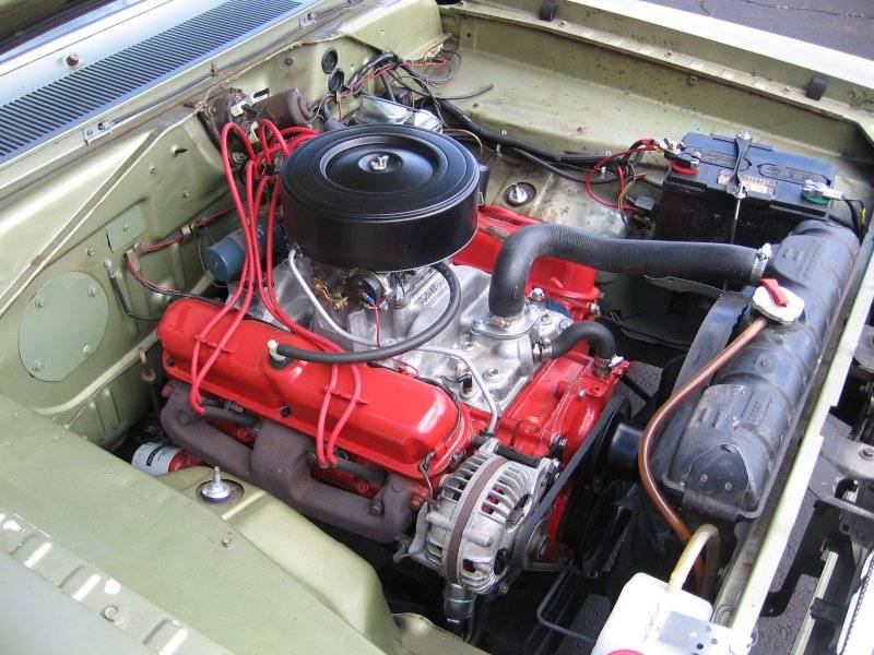

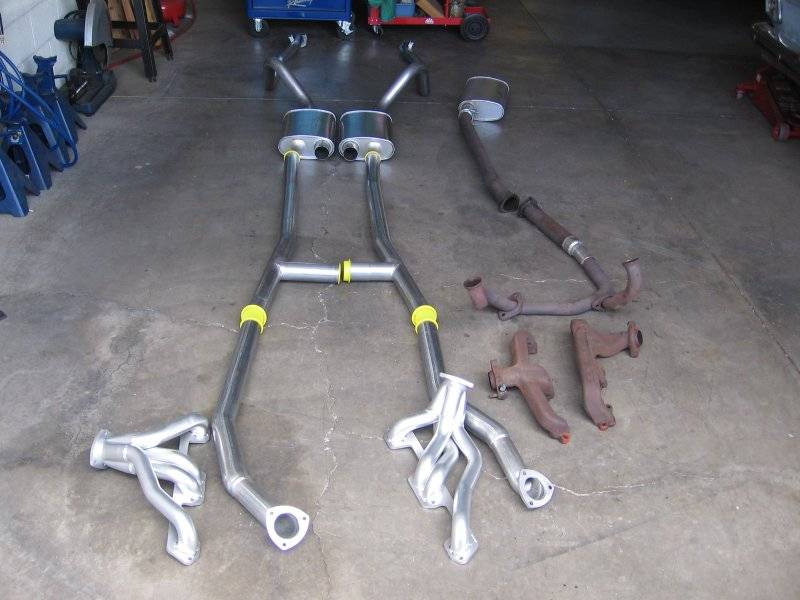

Just a few photos for you to ponder.Second photo is before headers and duals.TTI shown.
Those must be the shorty headers. I have the full length ones on order.
Yes,First time using the shorty's. Installed dozens of the long tube sets. I just wanted to try them.You loose torque with them over the long tubes.
Not the best choice for a 273.Car was a driver not a racer.
