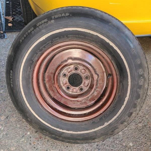

This is the original spare from my 71 road runner. I'll have to dig it out of storage to get a measurement.

Finally got a chance to measure my old goodyear F 70x14 and the white stripe is 3/8"

F70-14 Polyglass GT "custom wide tread" from my '70 Superbird that has never been used. The white stripe sidewall was 3/8, and this specific tire remained virtually unchanged all the way through the mid-70's. I have one that is date-coded 1974 and it is identical in appearance.
