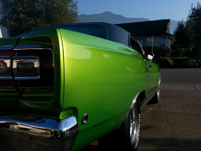

I went with AMD rear quarters on my 68 b-body, after considering the other reported junk on the market. They were on and off the car using self taping screws several times, before my body man got the outer wheel wells and quarters fitted up nicely. You can be out a 1/4 inch or more (forward or backwards) when doing this fit-up. I would recommend, you bolt on your trunk lid and quarter extensions, prior to welding up your new quarters, just to make sure that everything is going to line up correctly when done. This was not done in my case - and my tail panel trim on the trunk lid is now slightly beyond my rear PS tail lamp housing, as a result of not test fitting all of the related body parts that depend upon the correct placement of your quarters. FYI. Once welded up... mine needed spot filler and repeated blocking, prior to paint. I am thinking, this is pretty much to be expected, if you want straight panels, no matter what you buy. I hope this info is of some help and good luck with yours.
Oldtimer...looks nice,I hope my tail light panel fits like yours,the contour on mine is so far off,just gonna take some work,I cant tell in your pic if the whole quater is filler or primer,mine has alot of die marks I guess,looks like dings when looking down the side,didnt notice them in the box but on the car they are def not straight,looks like a light hail storm

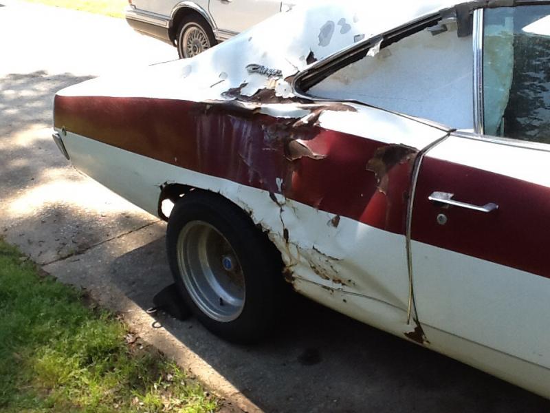

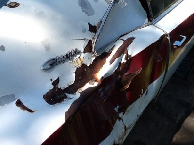

I guess it sucks to be me since I need a quarter and I was going towards the amd route.

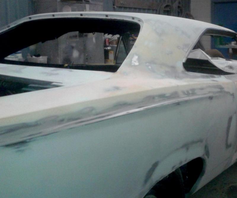

Out of the box, the AMD quarters looked smooth and straight to me. Excellent quality I thought. Once welded up, a little filler was needed here and there to make things perfectly straight prior to paint. This is normally the case, no matter what you buy. What you see mostly in the one pic, are the remains of interim primer coats, during a series of increasingly intrinsic blocking jobs, obviously requiring more work along the top horizontal welded edge of the quarters, than was the case else where. The rear contour of my AMD quarters, didn't match my quarter panel extensions (tail light panels) all that great, as I recall, and yes, my original extensions had to be modified slightly, to match the new quarters. The new extension seals, I bought in good faith, didn't work worth a sh@#... The pin locations and angles were all wrong, so I ended up having to make my own, laying down a thin black, tacky on one side foam weather strip, far enough inside the body line, that when fully compressed after bolting up your quarter extensions, the resulting paper thin clean line of the compressed foam seal is visible, as it should be, but remains fully within the top horizontal and vertical side contours, requiring no trimming if done correctly. This method cleanly and effectively seals any minor variations in depth, you might have between the these two body parts - more so, than do the lousy fitting, plastic seals, I could find on the market. Minor adjustments, using this alternate sealing method, can easily be repeated, if required, to ensure that perfect look and fit. FYI. No matter what you decide to do... have fun with it and good luck :)
