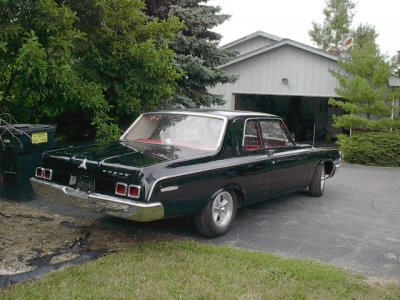

15x7 with 235-70x15 bfg t/a.

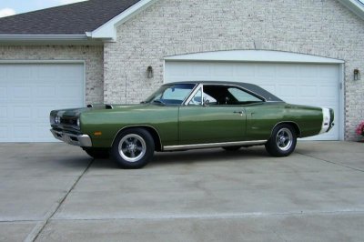

15 x 6 215/70/front 225/70/15 back Michelin Redline radials

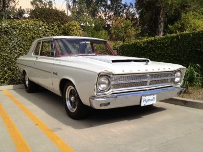

15x7 all around with 225-70x15 bfg t/a.
