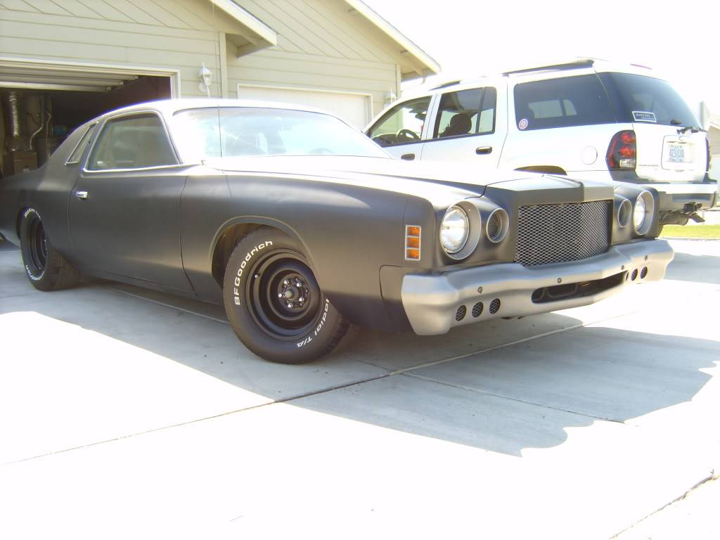

I've got Gabriels on the back of my 76 Cordoba for a kind of other-side-of-the-same-coin reason; I wanted the rear lowered. The idea really came from an AirRide tech who told me that with their basic setup the bags control the ride height (duh) and the leaf springs only serve to locate the axle. They cease to serve any suspension function at all. Even the basic system was too spendy for me but by-God I could afford a pair o' HiJackers (funny Rabbit stickers no longer included. Bummer).
It's not exactly plan A, but I haven't had any of the problems that people are talking about here. A few passes down the strip might require me to amend that statement.
That said, I will be keeping an eye on the upper studs and crossmember from now on...
That's a mighty clean and straight Cordoba. What's the deal with the place where the trunk lock goes? Shavin it?
Thanks. The guy I bought it from didnt have a trunk key. I butchered it pretty badly trying to get it open so I just cut a rectangular hole to make it easier to patch....which I will surely do....someday.:toothy10:

I don't mean to sound like a smartass, but couldn't you have done the same thing just putting regular shocks on? Shock absorbers don't affect ride height unless they are air shocks with air in them or coil overs, both of which will raise the ride height.
Thats true. The car sat up too high for me so I lowered it to my liking by removing leafs. Hell, there were 6 per side so I figured it could stand to lose a couple. When I had it at an acceptable height I ripped an inch and a quarter off some 3" blocks I had around and lowered it a bit more. Now I add air to get the height I wanted. It's basically the same setup as AirRide's Shockwave, which bolts in place of your regular shocks while the leaf springs do nothing but locate the axle. With the Shockwaves you remove ALL but the main spring. I didn't go that far cuz Im using just plain ol' airshocks.
I can't say it's an optimum setup, would probably suck and then tear the *** out of my car if I added power and went to the track. But this isn't a race car, it's just a driver. On a good day I might call it a mild custom, on a bad day I might call it a beater. Kids and dudes dig it, chicks hate it.
