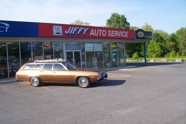

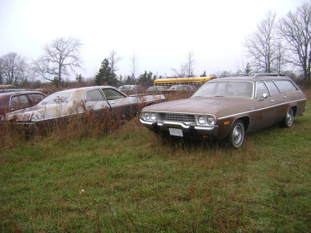

The waygun's springs are bagged and I have air shocks on her now.
Using them as a band aid since I do haul schtuff with it.
She is my daily driver and kinda hard to take it off the road to replace the springs.
Not to mention,the wagon specific shackles are not in repop and I am leary if they would survive from the repair.
I dont mind the ride.
It is not that harsh after you play with the pressure enough to level the car.I find 45 PSI is good when the car is empty.
Here she is hunkered down before the air shocks.
After the air shocks
