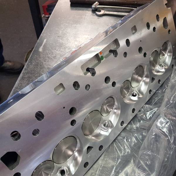

Well the 270 heads arrived yesterday and today .

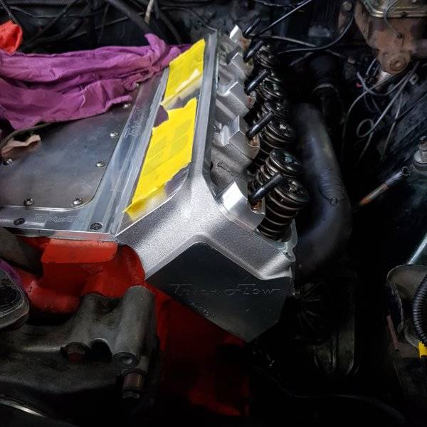

Gasket matched the intake . Now to fit and then see about pushrods .

Pics
Tex

Quick run around block today , feels fine . 5500 stall means cant tell if different . Was wet and cold so no blatting it .
Changed oil
Did some mods to the dominator , idles lower and happy at that
May chassis dyno it next week to check afr
