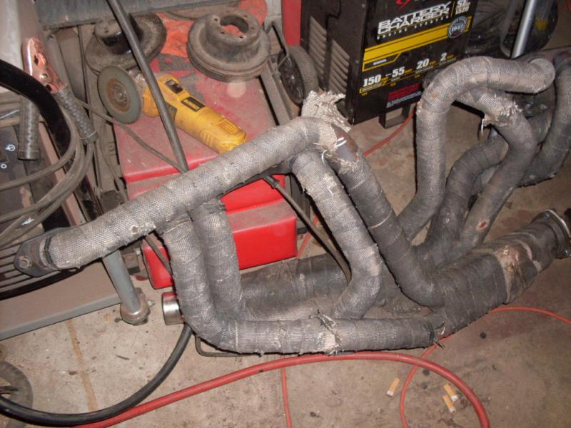

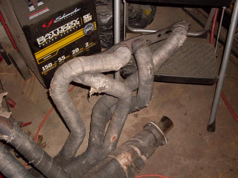

Bought these headers years ago when I bought another car. Going to try and put them on my RR. Can anyone tell me who made these. If it helps, they are black with the 3 bolt flange. Just curious cause they look like they will fit tight when I get them on my car. Should I leave the wrap on?

Yeah I aint a big fan of header wrap either. They could be anything. Maybe if you unwrap them you can find a brand name or part number.
I am guessing from the bends, hooker... However unwrap them! I am now curious!

My vote is Hooker comps.
Thanks for the replies. And Richard, thanks for the photo comparison. Will take the wrap off later today after I run some errands which includes taking giving some money to my daughter so she can get her hair done for her prom tomorrow night. Will see if I can find a brand or part number.
Took the wrap off and there is a badge that says HOOKER COMPETITION. Short of ceramic coating, can I use high temp paint to make them look good again ,and what temp rating should I get? 1500- 2000 degree or higher?
