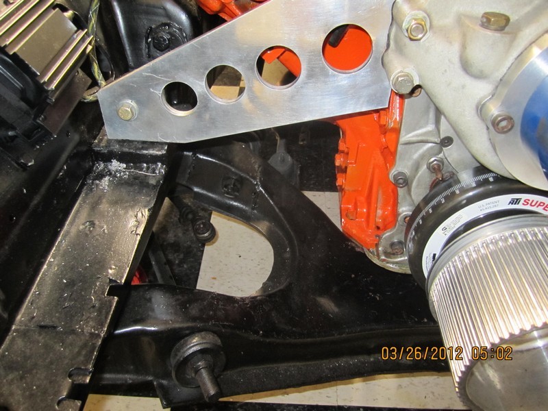

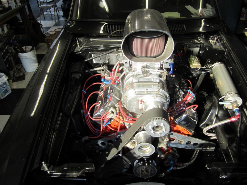

Elephant ears,,,,,,,,simple solution!!
Is your engine even mounted to the K frame? Or is it held up by the frame with the elephant ears?
I really like that idea. Did you make those or are they sold elsewhere?
