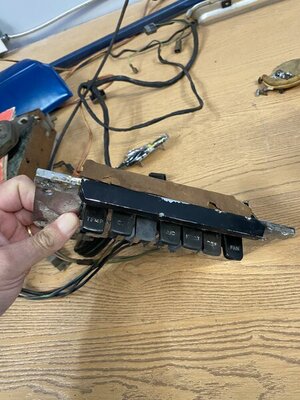

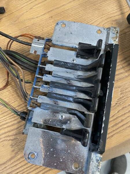

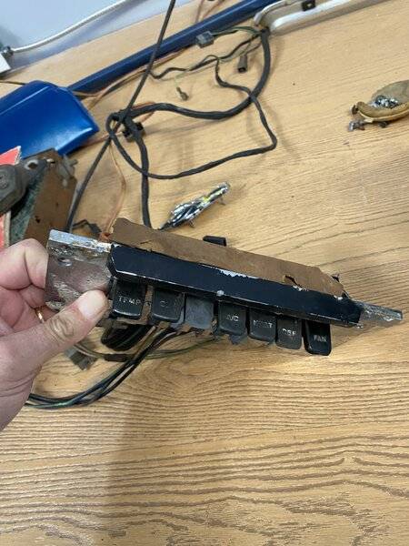

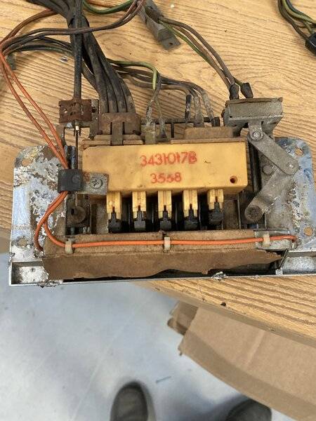

Any source for getting this rebuilt, or where I can locate parts to build myself? This is for my 69 Super Bee with factory air.
Thanks in advance.

Find an nos vacuum switch and do it yourself.
its not rocket science

Be aware that some of the vacuum switches are not configured the same. From my research, I have found these part numbers to be the same. 2820487, 2571501, 3431017, 3431020 and will work in your 69 Bee.
Pn. 3895790 runs the compressor in Defrost mode constantly.
Pn. 3502126 runs the fan on low with ignition on and no buttons pushed.
There is another pn 3895033 that I have not verified. May or may not be the same.
I have been concerned about compatibility as the ones I've seen on ebay are not the same as my part #. I'll crosscheck with this. Thanks so much.
The part in your pic is the correct number. You should be able to find one on Ebay. Seems like the people that have them think they are gold plated though. If you are not into numbers matching, any of those four numbers should work correctly. You may be able to fix yours if it has just come apart. I bit the bullet and got a new one although the one I have in my 68 Charger is the 3502126 part that runs the fan on low when the ignition is on. Not correct but it doesn't bother me since I usually have the ac on anyway. Good luck finding on without the gold plating.

It's kind of a bitch but it's doable.
I rebuilt one from a 66 and another from a 70.
Take your time.
There are several "wafers" or plastic sliders that slide against each other.
I was able to grind off the edges of the pins that hold them together, and still have enough left to melt back over.
Make sure you place the wafers in order and orientation as it's easy to mix them up.
I labeled mine with a number and "top" mark.

It's also SUPER easy to break off the nipples.
So be careful there as well.
I wish I could remember what I used to lubricate those wafers.
Might have been dry graphite.
