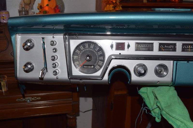

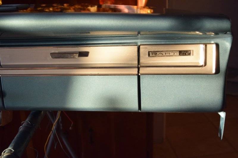

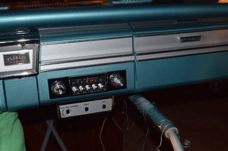

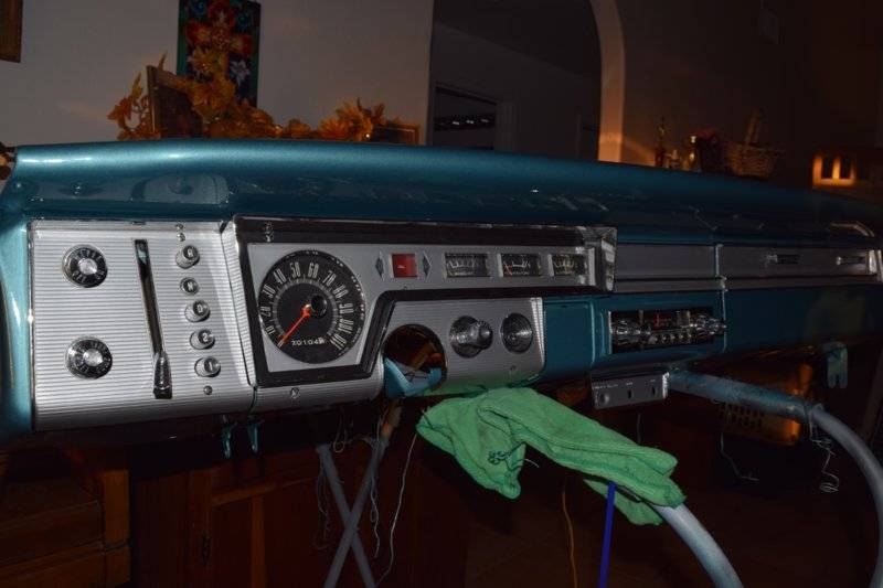

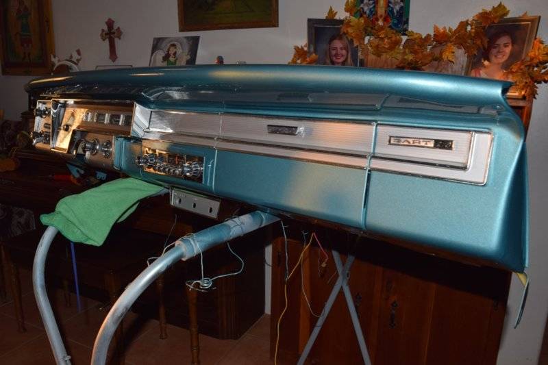

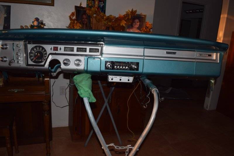

Vacuum Orna-metal in Michigan. 6 weeks door to door. Frank does the restoration work for some of the dash restoration places. Here are the pieces he restored for the wife's '63 Dart.... He will give you a quote based on the car. Excellent communication and was true to his word on delivery. There was exactly zero trace of plastic chrome on these parts when I sent them.
https://www.vacuumorna-metal.com
He did the Push Button shifter bezel, instrument cluster bezel, radio bezel, heater control bezel and arm rest bases for me including polishing the lenses.

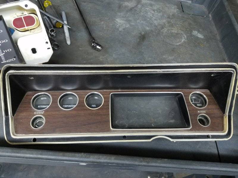

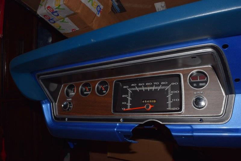

We did the daughters Duster with "chrome" spray paint which does not look like chrome. The Duster has so little chrome (just around the edges) you can't really tell. I used DMT laser cut decals for the wood grain it it looks fine.... but today I would just send it to Frank at Vacumn Orna-metal.
I was thinking the same thing, probably wouldn't get it back until next fall.
Definitely not a show car, just a fun driver. Getting tired of looking at the yellow plastic underneath the chrome though.
When you say do it yourself, a guy would still have to send it off for the chroming?
Nope.....I just used chrome paint........Not the same as PC of course but just how many even notice....As you notice the yellow, everyone notices that....
I even had people asked where I got it restored at.......

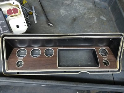

That turned out plenty good for me for this car. So did you repaint the black inside the gauge holes? That looks to be a real pain to get taped off nice. I will get a hold of Frank, but if he is really backlogged maybe your daughter would like a little project....
Don’t they repop those Duster bezels?
Yes we did. Sprayed it from the back if I recall correctly. Yes there was a LOT of tedious masking. If you do it get some of the purple 3M vinyl masking tape to tape the edges then use the masking tape to just keep overspray off. The 3M tape gives a nice crisp line. I found the hardest was the perimeter black where there are 2 parallel "chrome" strips. If you look close you can see some bad spots.
