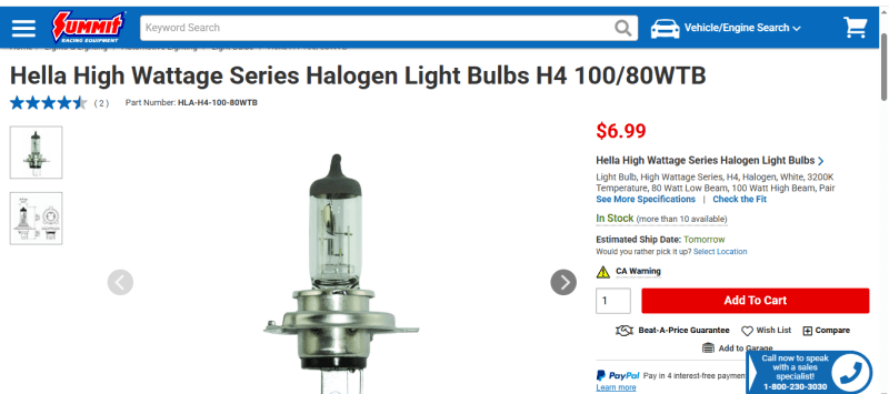

Hella H4 100/80WTB Hella High Wattage Series Halogen Light Bulbs | Summit RacingDid I also miss what type bulb a Hella brand light uses?
I seem to recall seeing posts about using the Hella shell and installing other types of bulbs. LEDs, for example.
Yes, there are several LEDs offered as replacements for H4s, will fit any housings designed for H4s. Issue is, that for most of these cars, they are too bulky on the backside and will not fit into the buckets without cutting holes in the fender structure behind the buckets. In that regard, the Holley Retrobrights don’t have this added backside bulk, fit without modifications.I seem to recall seeing posts about using the Hella shell and installing other types of bulbs. LEDs, for example.

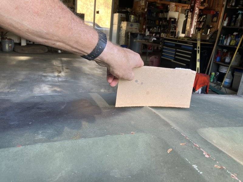

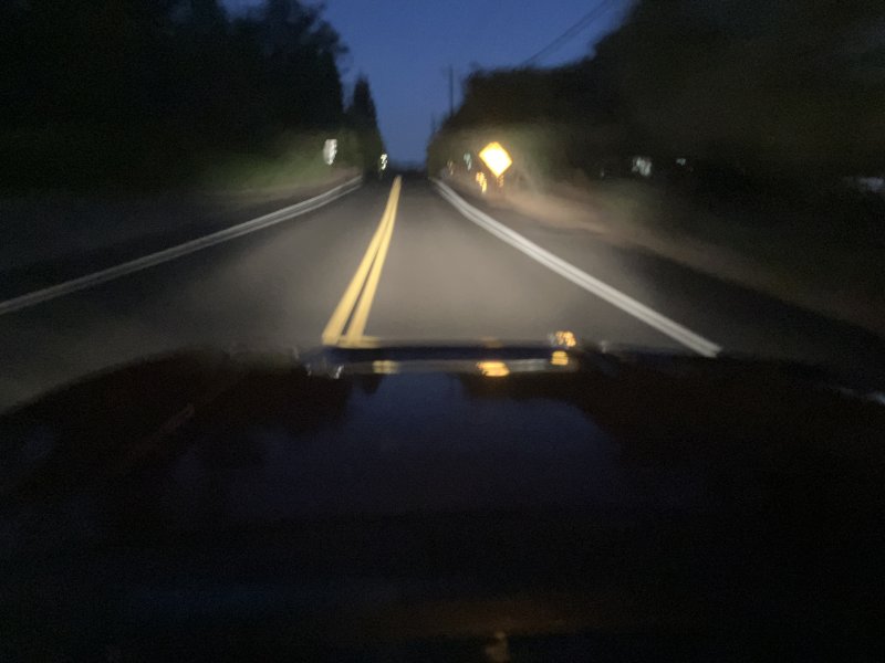

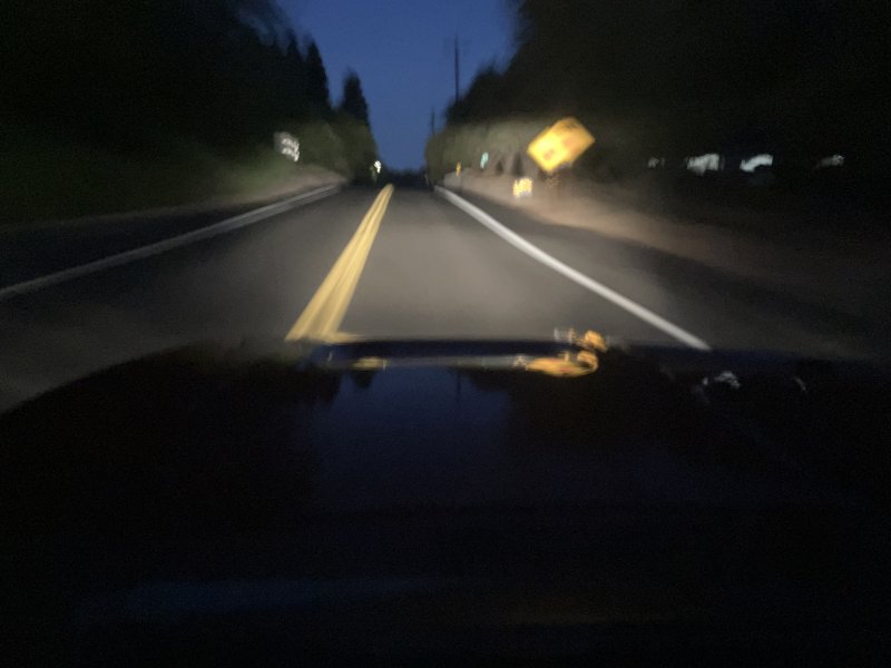

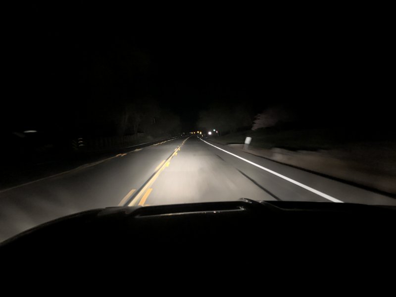

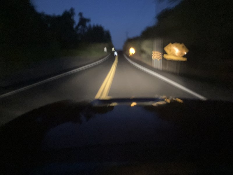

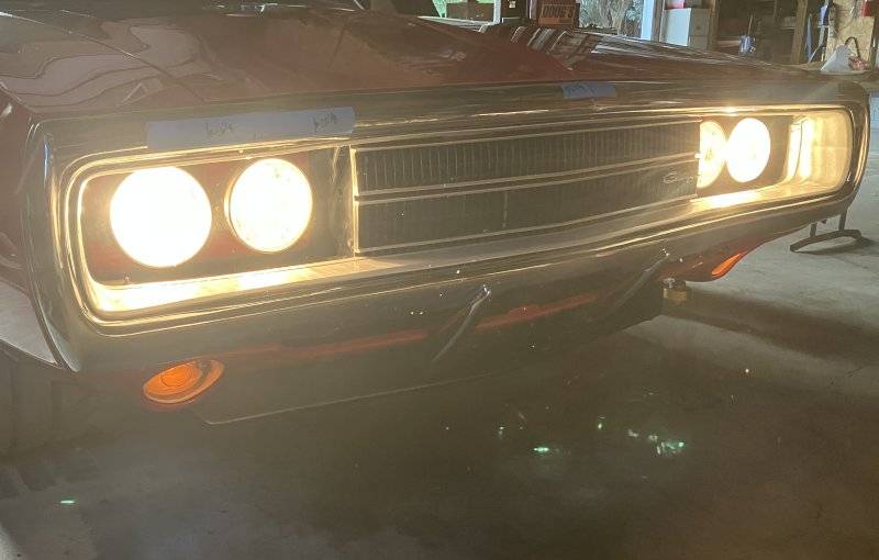

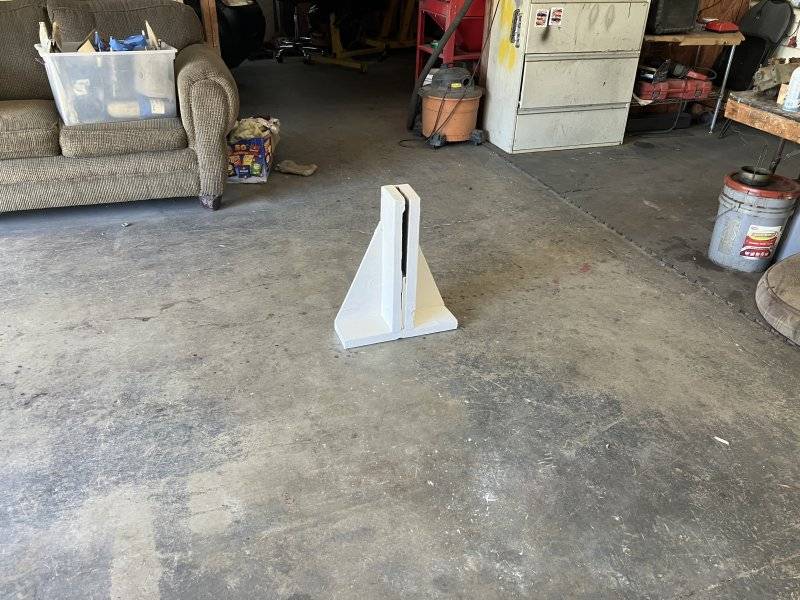

The light pattern of these bulbs seems fine, I just need to aim them right.

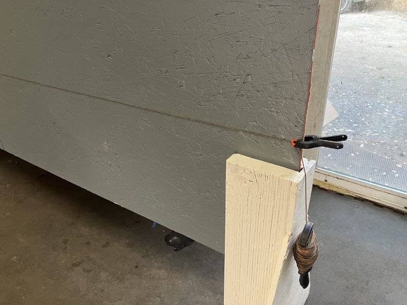

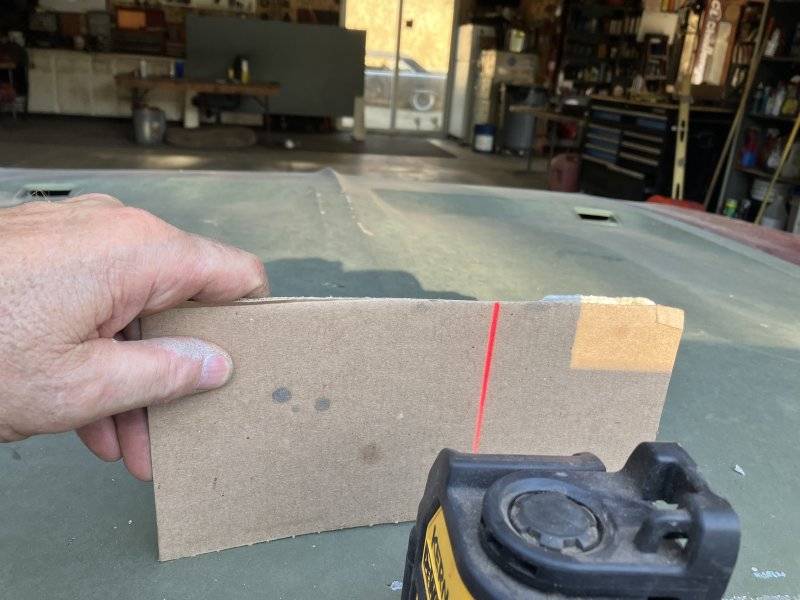

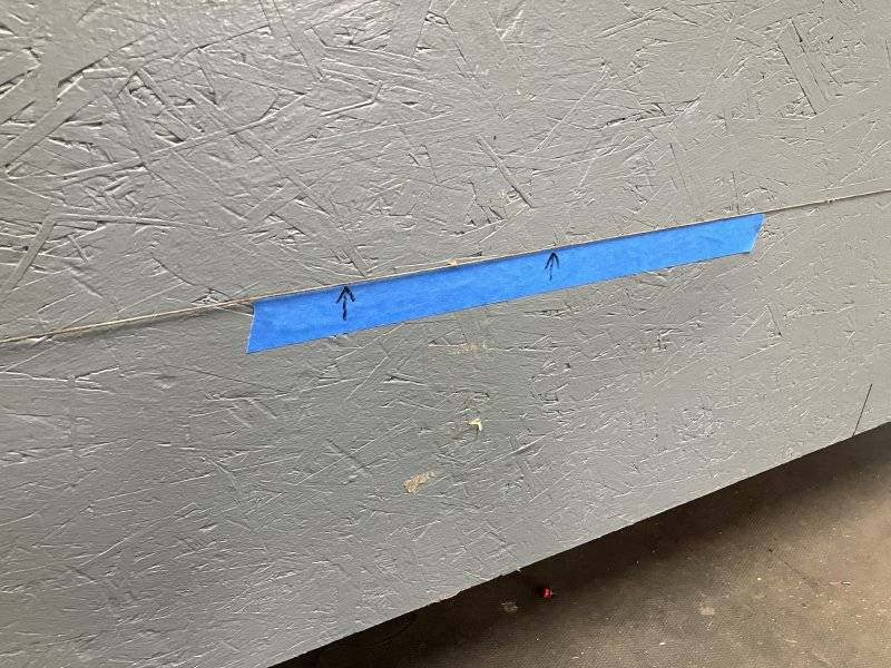

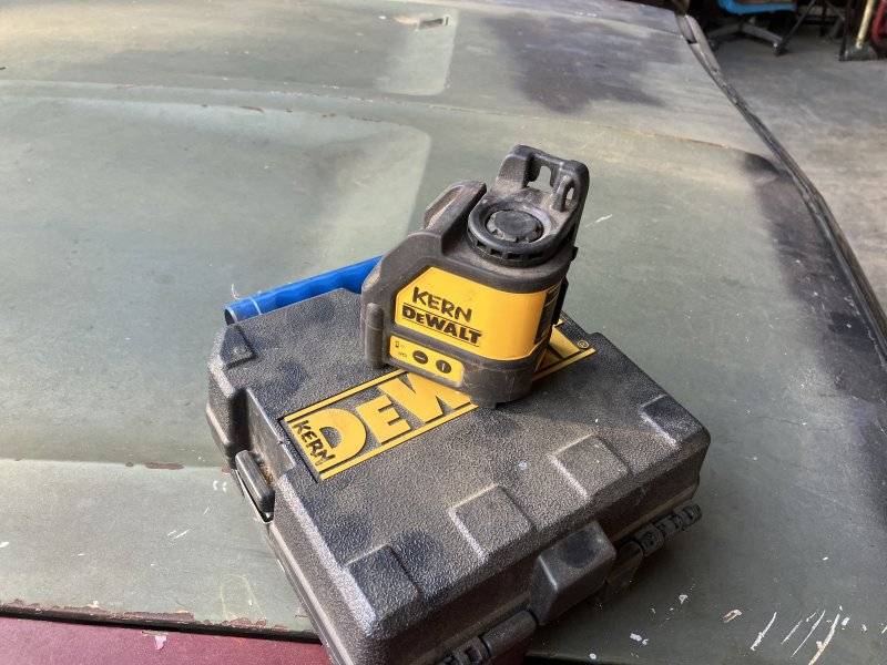

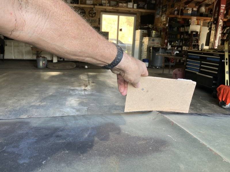

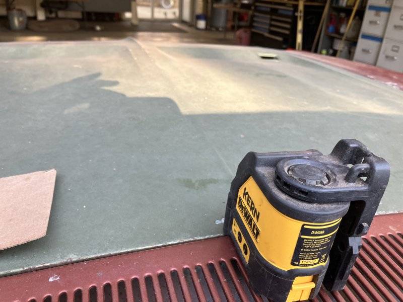

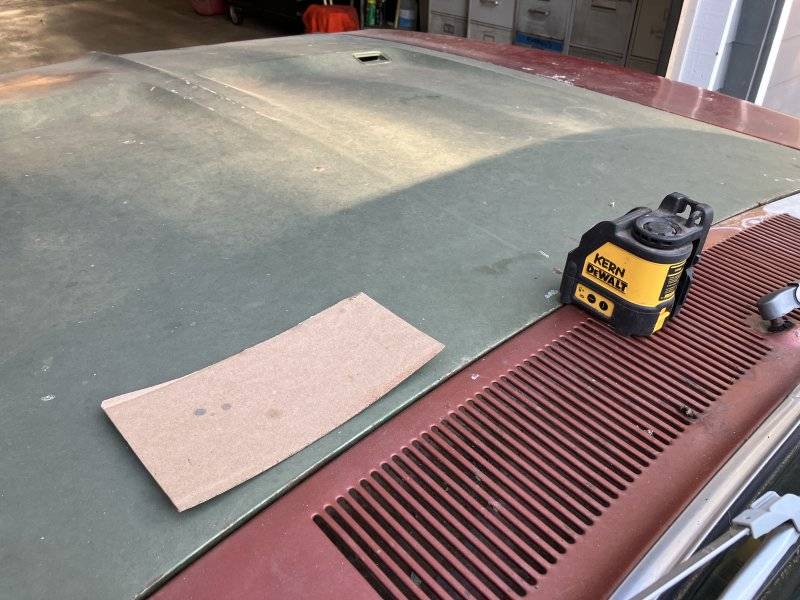

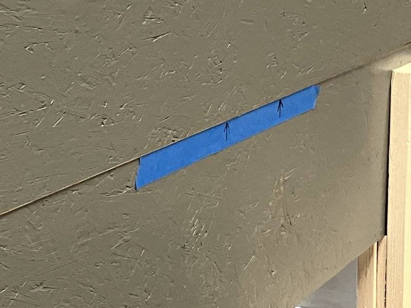

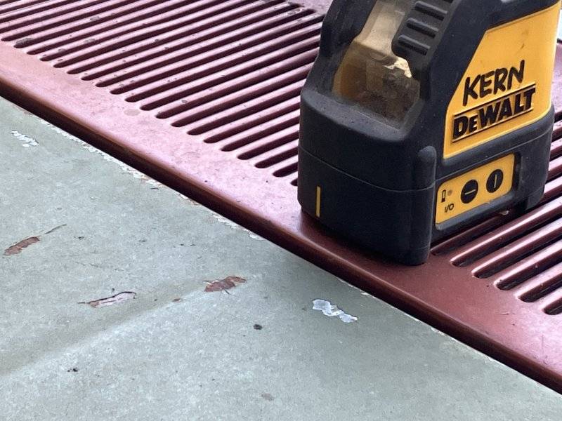

I may have figured a way to do it here. If I put the car with the back tires at the edge of the slab….

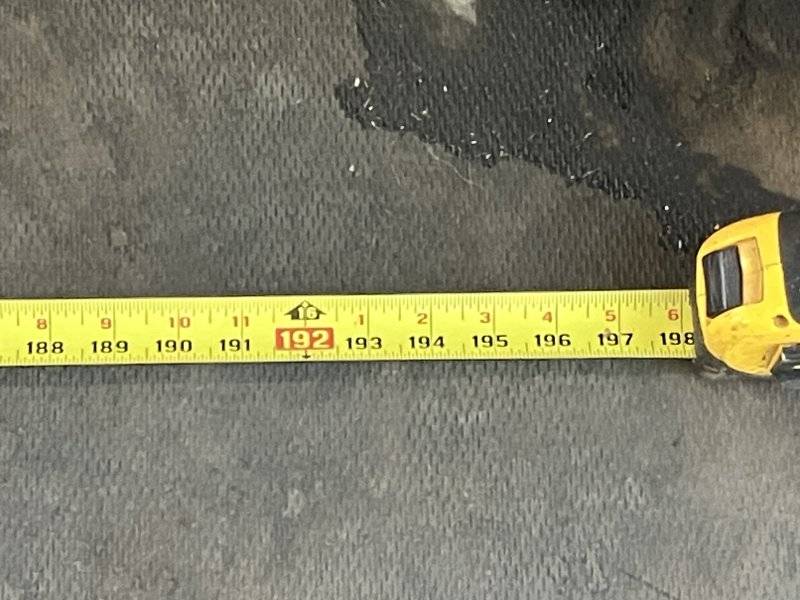

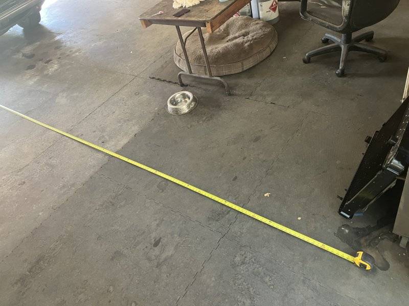

Rolling out the tape…
I’m just over 16 feet to the cabinets.

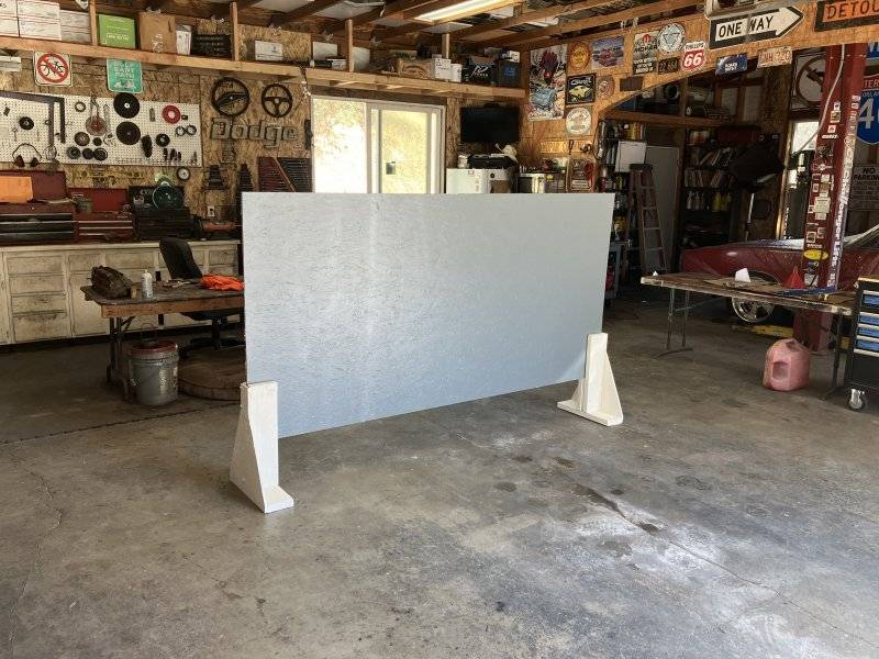

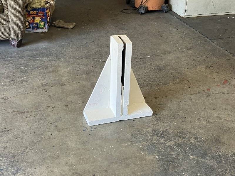

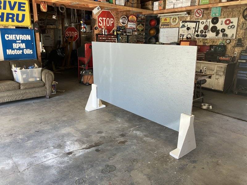

I just bought a sheet of plywood to use as a “wall” To aim Against.
More later ….
Focusing the available light where it is needed and useful rather than scattering it about will in most cases at the least increase the perceived brightness.The goal here was not just headlights aimed properly but also brighter.

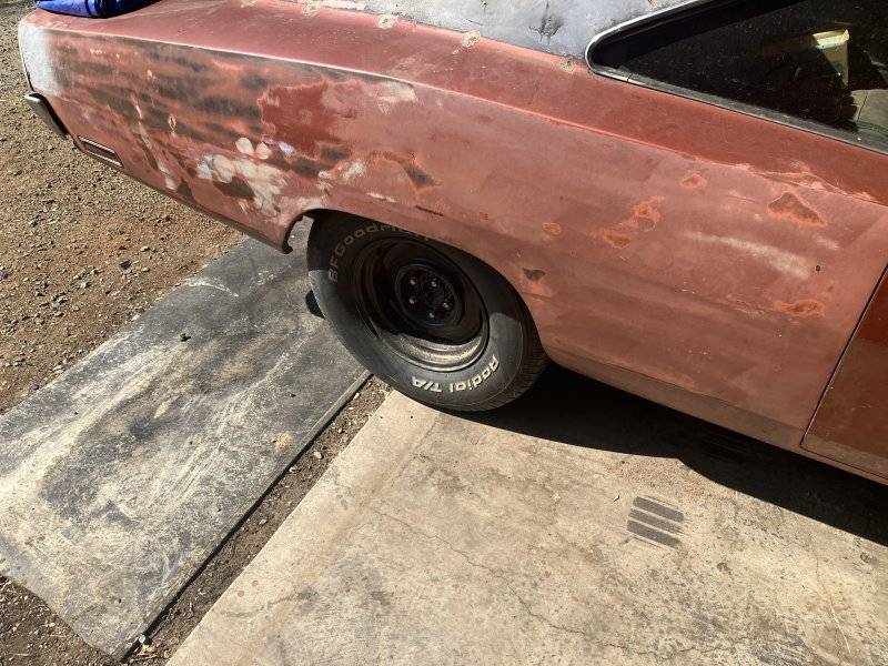

Not sure we or anyone should today consider your car being sprung as normal, ideal maybe, but not normal.I do have to state that with people in the car and a full tank of gas the car doesn’t settle much.
Ha, you're too kind. Perfection ? Not really, just better than average I guess. I wanted safer and better night vision.I have to applaud you for all the effort you put into adjusting your headlights. You are a person who seeks perfection, in the projects you undertake.
