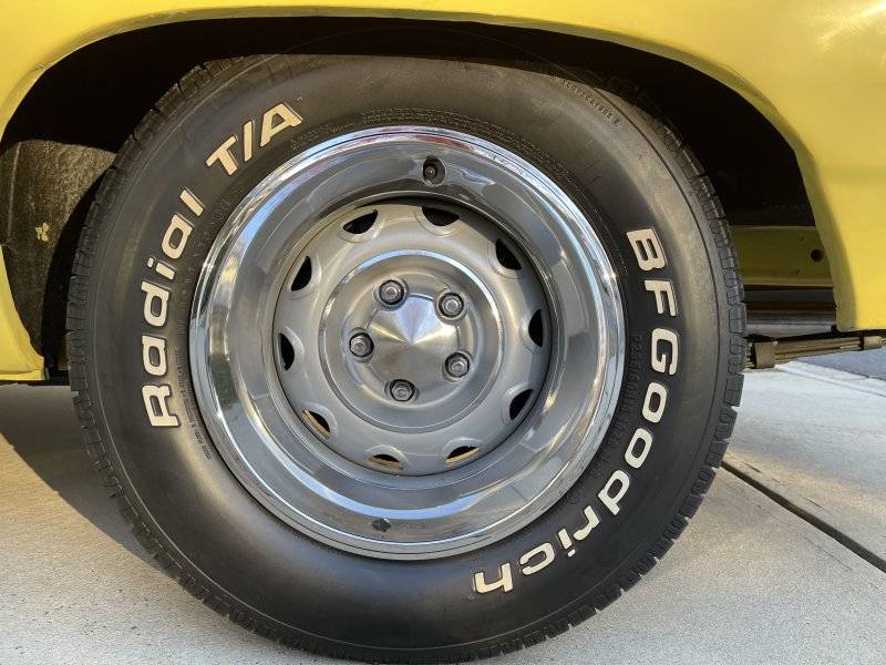

No. I cannot feel the sound anywhere. Originally I had a vibration which was a yoke and they straightened and balanced the drive shaft. Vibration gone. Now just the sound. And (before everyone goes nuts) the ties are old. Embarrassing 2011. The car sat a long time. They were next on my list, maybe a radial M/T sportsman if I remember right. I wanted to burn these off first. They are 255/60/15 BF. According to the tire calculator they are a 27” tire. I’ve put it off trying to decide on a tire size. 27 or 28?

The BFG's on my diesel are from 06!! Yeah, I don't drive it very fast with them but so far, they ain't wopping. I would for sure jack up the car and roll the tires and see if you can find any high spots in the tread. Been down that road many times and with tires that were much newer. I HATE steel belted tires!
