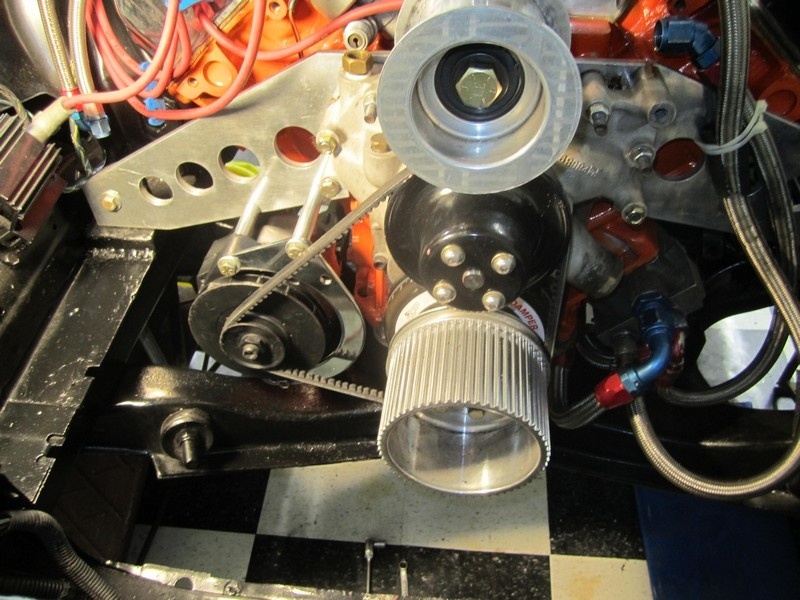

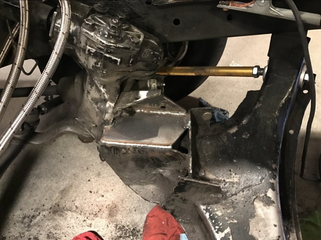

Modified the steering /motor mount to accomadate my external Indy Maxx pump. Getting it ready for paint
Space the K-frame down from the frame rails. While you're at it wack the center out. You'll be happy you did. I cut and welded my sons 62 while still in the car.

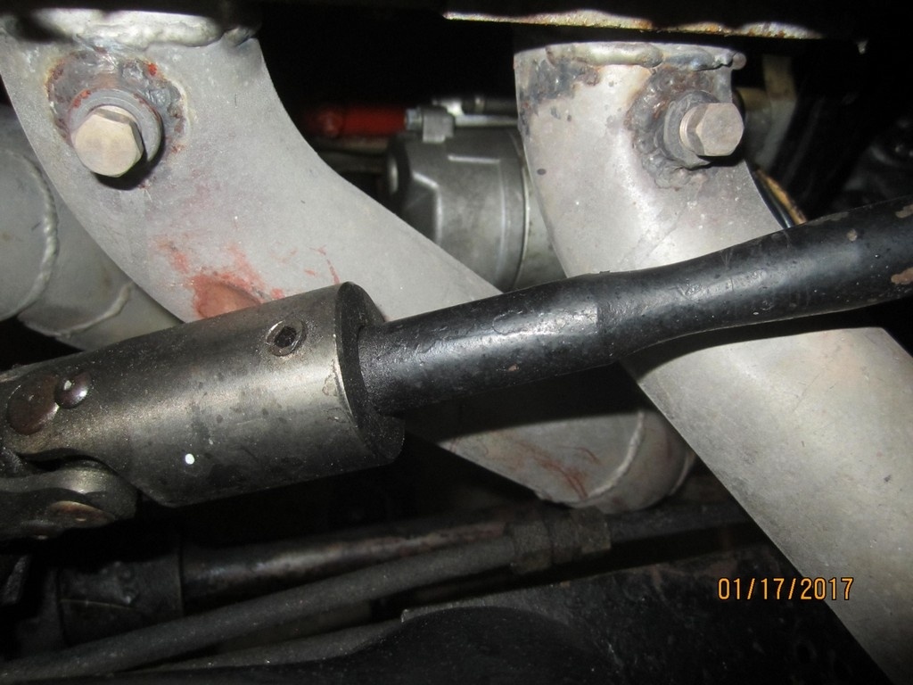

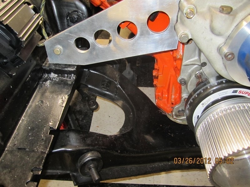

I used 1/2 inch square tube to raise my engine for centerlink clearence.

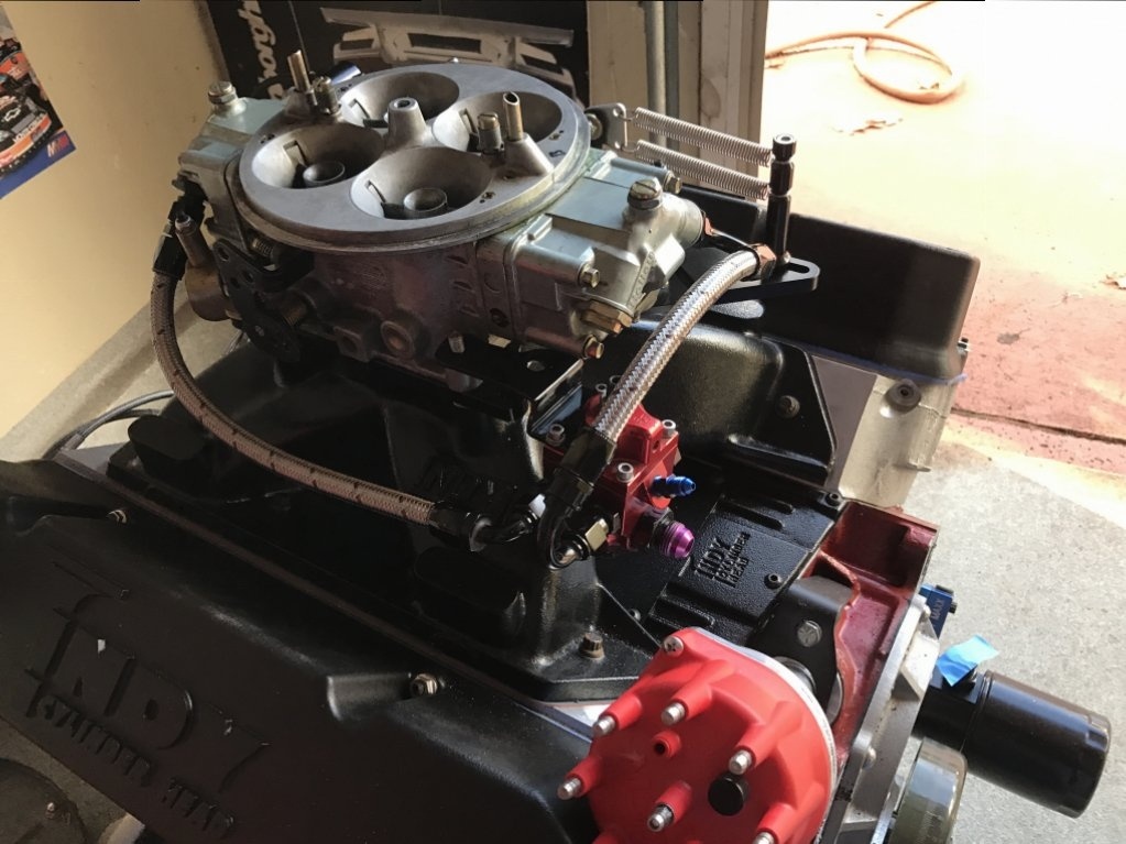

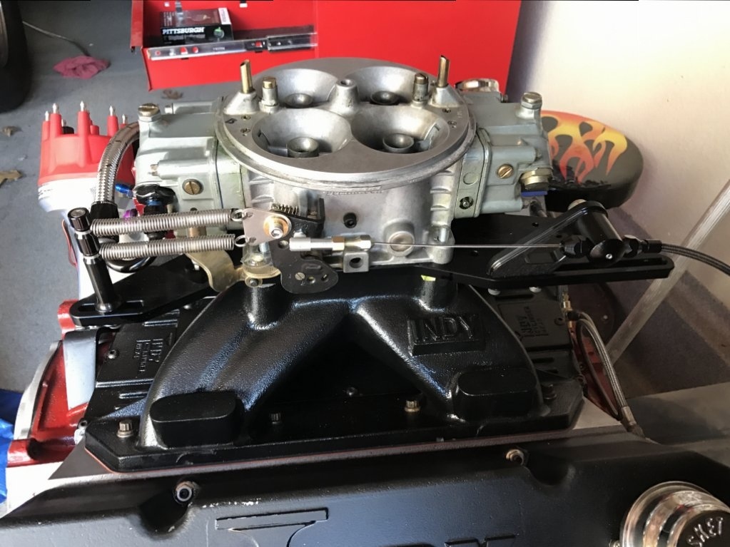

Winter is quickly passing and I am still waiting for parts from summit (trans shield) still wont ship till 2/3 but, in the meantime I setup my throttle linkage and return springs. Here are a few pics. IMG_06111.JPG

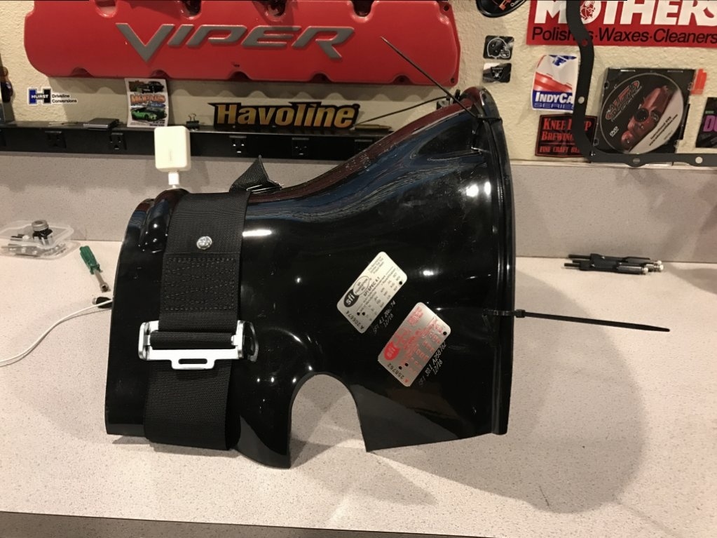

Finally moving forward. ready to install my shield to meet safety requirements. This part took a month to get.
You might have to massage the pinch weld between the floor/trans tunnel and firewall.
I am going to cut out the tunnel and fab sa new one something that will make it easy to remove from the top.
I like that idea,do you have a plan?I'd like to do a belly pan after the fabricated oil pan also.
Plan I have no stinkin plan (LOL) actually I do but venturing into the unknown a bit. I just feel its the best way to install this shield since it's so tight and nearly impossible just to get it into position without removeing nearly everything. Since the motor is out its the perfect time to venture into this area. Belly Pan well I did a pan unter the engine but, I needed to take a second look since it didn't work that well when loading and unloading it from my trailer. So at the moment I don't have a good plan for that.
View attachment 387069 View attachment 387070

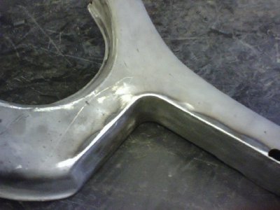

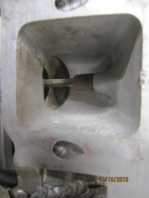

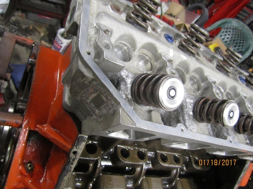

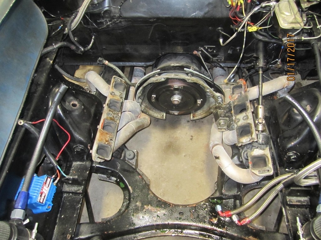

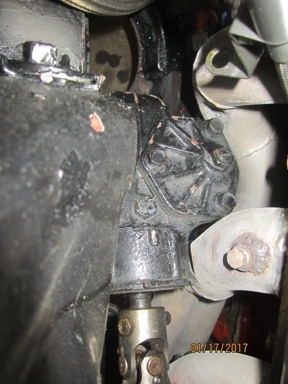

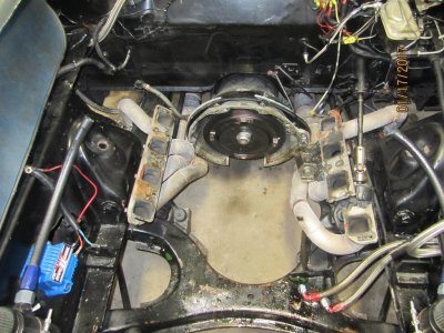

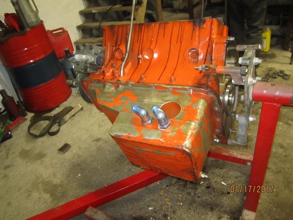

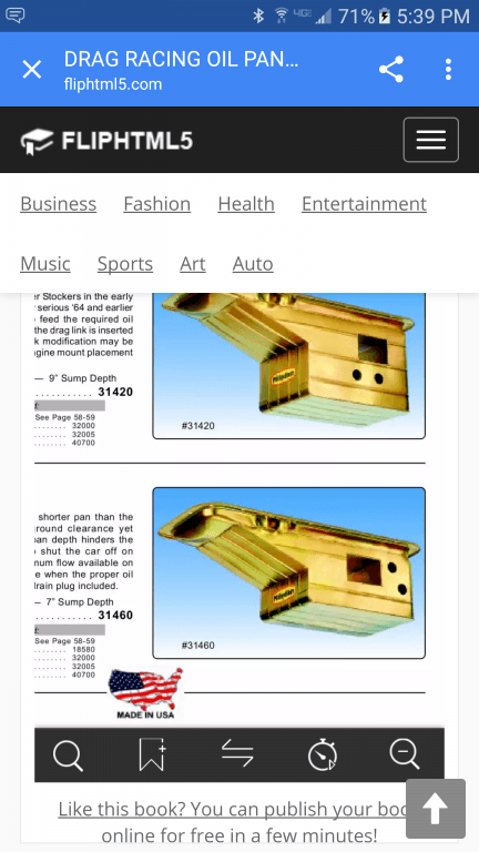

I am now in the process of lowering the engine back down.The aluminum heads that will be used have a .750 raised exhaust port.While the engine is out the "K" will be made to duplicate DVWs work of art.
Will also have an aluminum pan fabricated.
1.17.17 007.jpg 1.17.17 004.jpg 1.17.17 005.jpg 1.18.17 009.jpg 1.18.17 036.jpg 1.18.17 044.jpg 11.14.16 009.jpg 11.14.16 010.jpg 11.14.16 012.jpg 11.16.16 020.jpg
