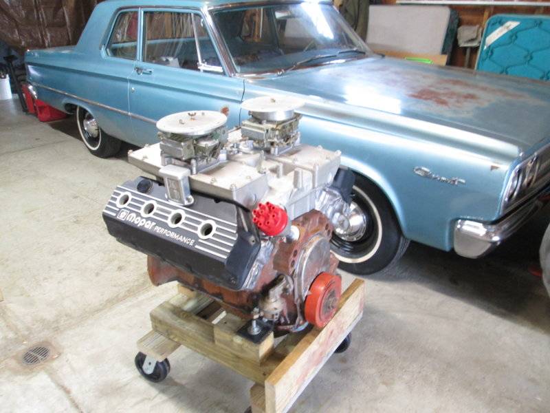

With the right sources, time & patience it can be done somewhat less expensive. If that can really be said in one sentence with the word HEMI. I have about $17,500 into mine with a combination of good used parts & many new parts. It took me several years of gathering parts but in the end it was worth it. Saved a lot of money, built it my way & it makes way more power than a crate engine & is still street friendly being a 10.5:1 pump gas engine.
