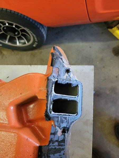

Well if anyone is interested, I pulled the intake today and look at what I found on #6 and #8 ports. No wonder it was having issues. I guess the previous owner had a oops during assembly...
I've never used the paper gaskets shouldn't need them unless you've got some weird head milling job that was done incorectly.

I ran paper gaskets on each side of the valley tin when I used thicker head gaskets. I ran .060 and .075 head gaskets in the past.
I don't plan to put the paper gaskets back in but will use the 3 Bond or Permatex #2 to seal it up the ports and black RTV for the ends. Does that sound correct?

Exactly. I like to have everything perfectly clean, dry fit the intake and make sure it fits flat on the heads at all corners. Then semi snug the pan rail ends, do the dull chisel treatment and commence with installation. A bit of thread paste on the bolts and go around the pattern several times as the intake squishes down and finds its home.
I did a thread on my distaste for the paper gaskets, exactly as seen by the OP.
I used the paper gaskets once.... Back around 1979.. Every printed manual said they had to be used when using an aluminum intake... I had an early A12 Edelbrock manifold & carbs on my Challenger... It ran so bad I was about to swap back to a 4bbl.... Then I pulled the intake & saw the same thing posted above.... Put it back together with a new stamped steel bathtub coated the port areas with some Yamabond left over from having split the cases on a YZ250... Back in the 70's Yamaha was the only place to get three bond in the US.. They sold it as Yamabond... Later Honda added it to their shelf & labeled it Hondabond... The actual maker is Threebond...
A backfire might have caused the gasket to shift...
