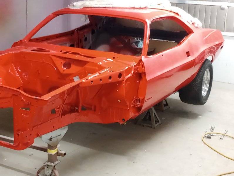

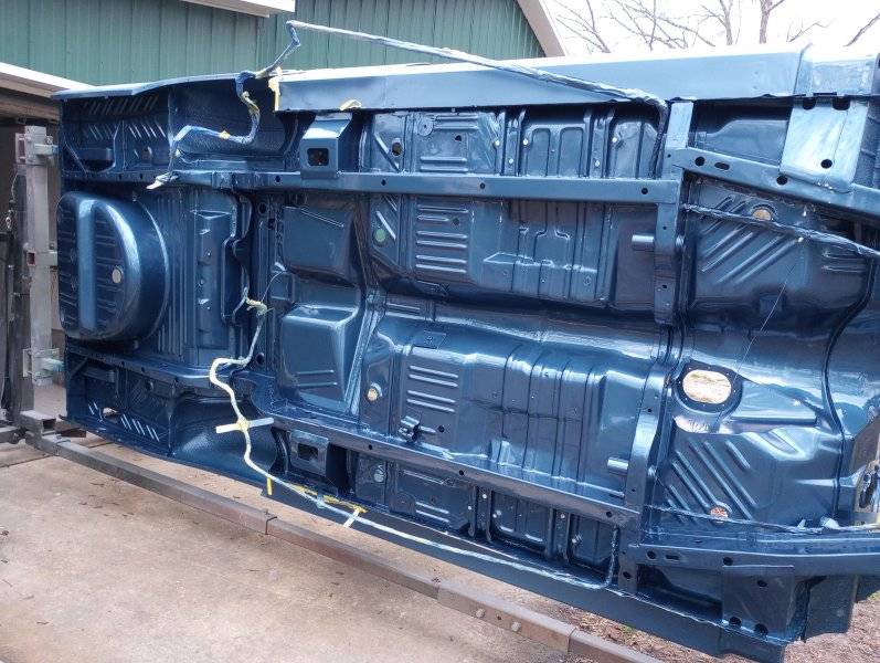

gallon of base for this was 360 bucks ....... used the matching lower end clear (Wanda by Akzo Nobel) for this under side and cut ins
How much a gallon?
Issue up here, above the invisible line, we got forced into water bases ****! Solvent based paint availability doesn't leave us many options anymore.
I was surprised the blue was that "cheap" :rolleyes:
hemi orange and limelight were significantly higher, but not double......... and yeah, solvent based; I have yet to use the water stuff, hope I never have to..... I'm tired of having to learn new things
So 360 US is 480 Cdn right now and that's your bottom price. Other colours higher.. now we're talking the same lingo! LOL
the blue also covers completely........ in 4 double passes

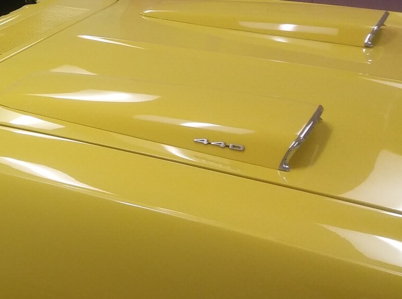

the orange and yellow were transparent to the point of annoying; and require 3 gallons to do the job...... and the yellow car didn't get the roof or underside painted; or it would have been 4
My Bee has 4 full coats of House of Kolor on it and then got Kleared, sanded out and then two more coats of Klear. Then got cut and buffed over a year later.
The Bird in Yellow, not sure how many coats it got for "full color". It had to be painted White first and then the Yellow over top to get the color right. I picked it up back in June and loading it back up tomorrow to deliver for her beauty appointment.
put that yellow over even a light gray sealer and it looks like mud until there is enough yellow on it :BangHead:
