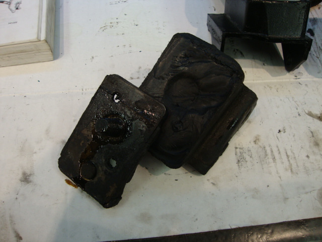

my money is on the motor mount. just did my left one and it looked liked this...
ive had a vibration the whole time ive had the car and couldn't pinpoint it. i think this was it.
Yep, I'd say mounts. The rubber can get soft if it gets soaked with oil and things go south from there really quick.
or maybe one old mount & one new mount, maken' her lean to one side
Mounts are more then likely your problem as previously suggested. Lift the engine up a bit to see what they do but I'd replace those with a good set of poly loc's to avoid future problems.
I've got an almost new set of poly locks that I took off. Way too stiff for me. Maybe I'll just get a new stock set and do the bolt thru thing on the drivers side....
