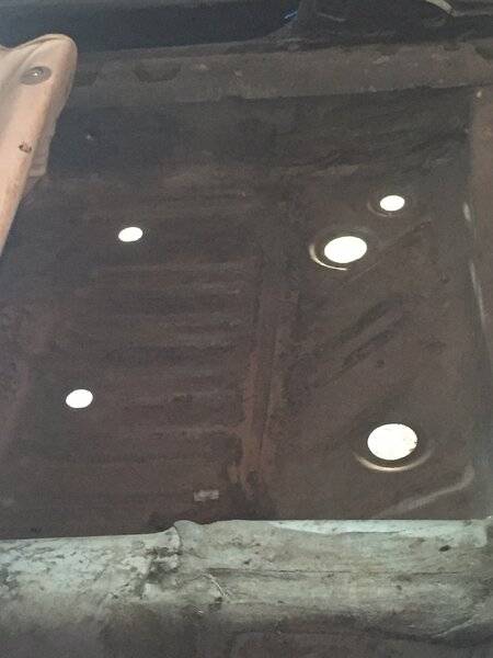

Why did ma mopar add so many of these things. Seems like way overkill to me.
Since plan on adding heat and sound deadener, are there any downsides to patching most of them up with sheetmetal?
The only time you would need them is if the car is flooded, I guess, so no harm in closing them up.

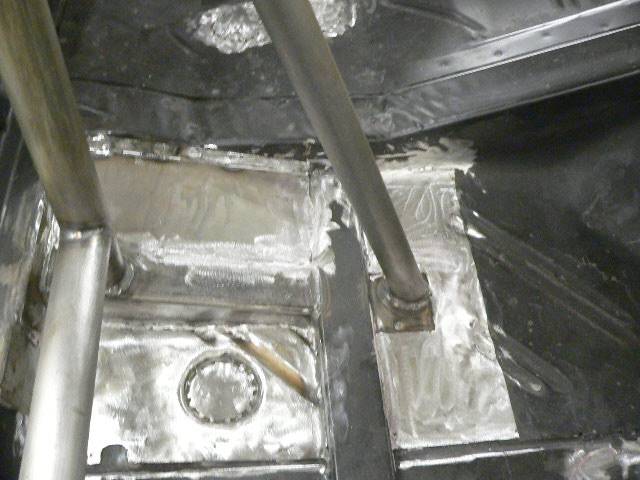

When I built my racecar every plug hole was filled with metal welded in. It was easy. Now if there is fire all entrances are blocked.
