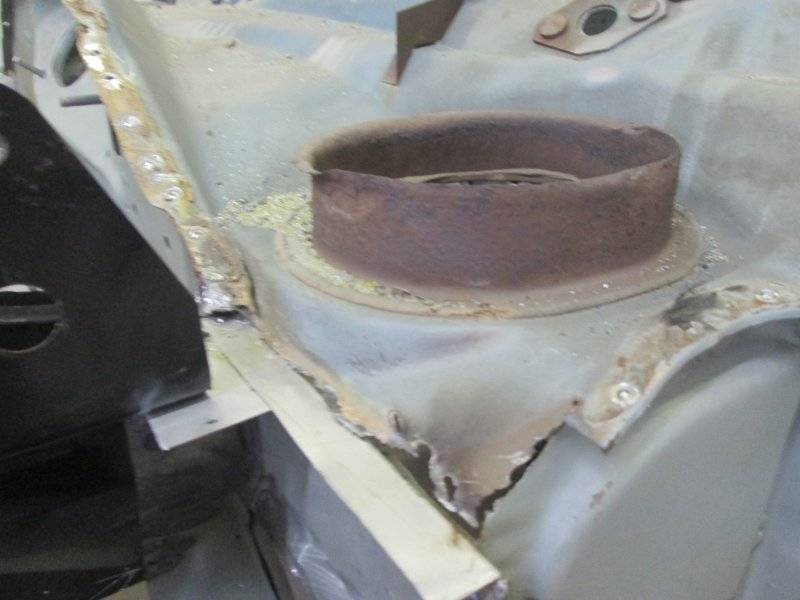

Because the lower cowl rots out from car sitting outside and the drain holes being clogged with eaves, crap and mouse nests..

Drill out about 200 spot welds, melt out the lead seams, etc.
...and replacement panels are either hard to find or non-existent.
I passed on MANY 71-74 cars because of cowl and hinge panel rust.

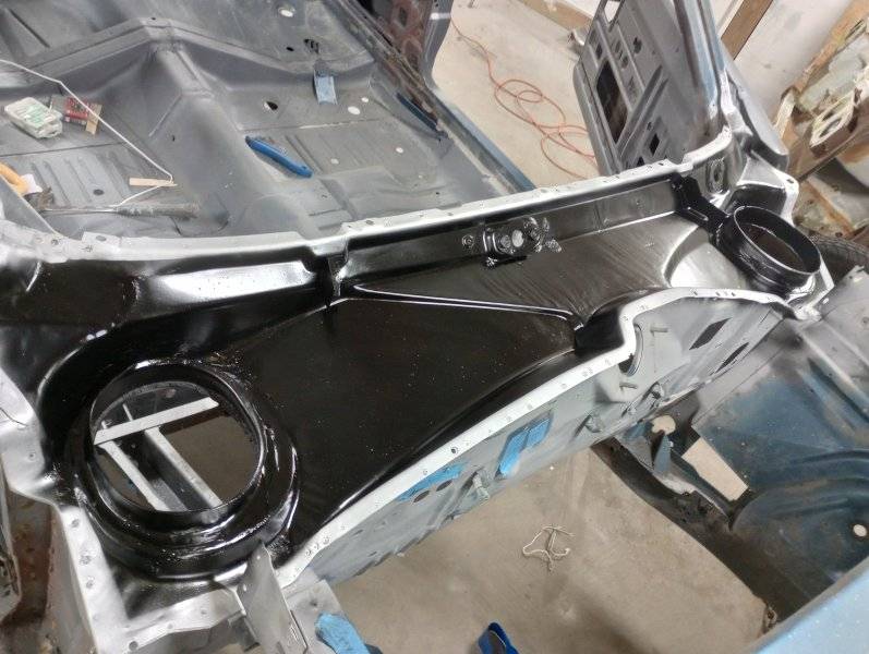

When I repaired the cowl on my 65 Belvedere I completely removed the panel to weld in the inner and outer patch panels. When it was assembly time I used weld thru primer on the under side of the outer panel and completely covered the top of the inner panel with fiberglass mat and resin, filling the drain openings (oval holes) to the lip on the outer skin-so they could drain. I then brush painted black Rustolem paint on the fiberglass and everywhere I could reach.
