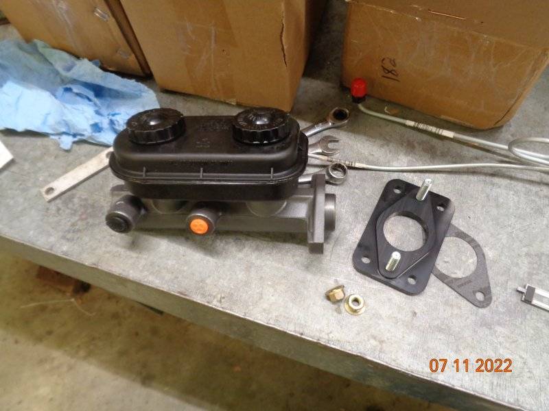

My 1964 Fury still has the original 10 x 2-1/2 power drum brakes. After doing a brake job, it does not stop well with the new, non asbestos, brake shoes. (It stopped very well with the old brakes, but they were well worn, and the cylinders started leaking.) I am considering changing to front discs, and know I will need a dual pot disc master cyl, add the required dual lines, and a proportioning valve. However, I'm not clear on whether or not I will need a different power booster. My original is the Midland Ross booster and the master cyl is the 4 bolt style. Anybody tried this before and can advise me? Thank You

OP here. The answer is that I installed a modern master cylinder with a 4 bolt to 2 bolt adapter to the original booster when I put the disc brakes on front of my 64 Fury. I got the brakes and the master cyl from Dr. Diff. It is working.
