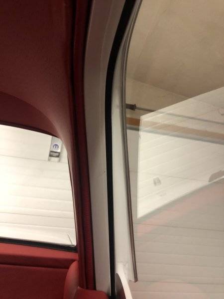

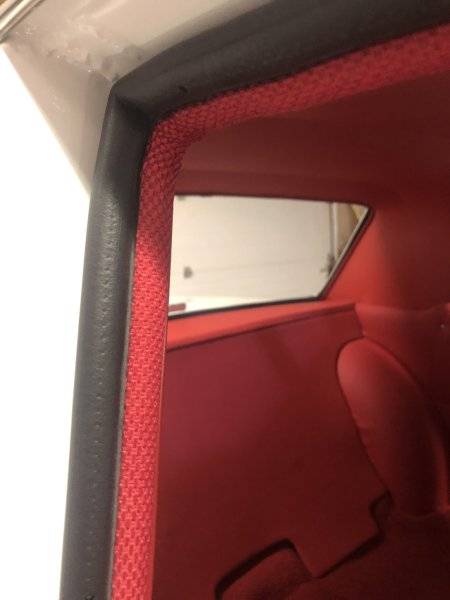

Working on my '63 Sedan door install. Does anyone cut, or trim the w/l, at the upper rear corner, or just force the 90* at that point ? What about any glue to hold these in place ? My '65 sedan survivor doesn't seem to have any adhesive used on it. Thanks for any/all input on this topic...
No cuts in my windlace. No adhesive either. Just pushes onto the pinch weld and stays in place.
I'm going to try to use this same w/l, for the rear windows also, by removing the rubber door gasket. Any suggestions on installing this ? Tight fit, but seems like it will go ?
The vinyl with no rubber gasket ? I know that will fit right in for the rears. I was trying to match the same for front to rear, but may go with that also ?
Make sure not to stretch the windlace in the corners . It can pull out of the tight corner as it sets in.
Try restoration Specialities for the trim that goes by the rear window I know I got red from them that fit perfect.
