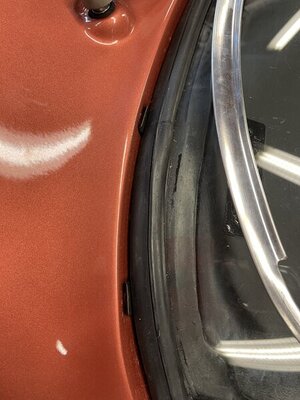

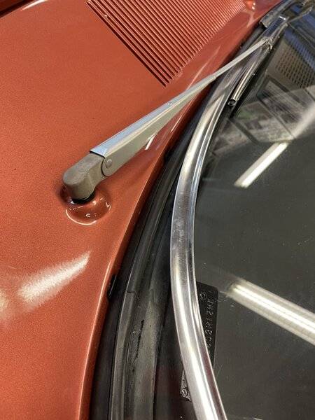

Are you putting the molding between the body and the clip? It won’t work if you’re putting the molding between the rubber gasket and the clip. I’m sure you already know this, but just asking. Your car looks the same color I painted mine. Is yours Bronze metallic?
Another thought. Sometimes you have to pound on the molding with a rubber mallet to get it down.
