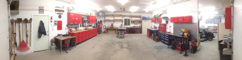

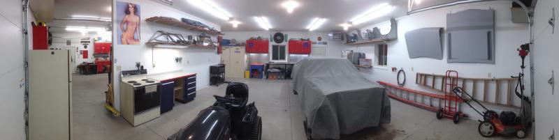

I got tired of that $hit years ago. The older I get, the colder I get.... in more ways than one.
I keep the thermostats set at a nice 60 degrees.
