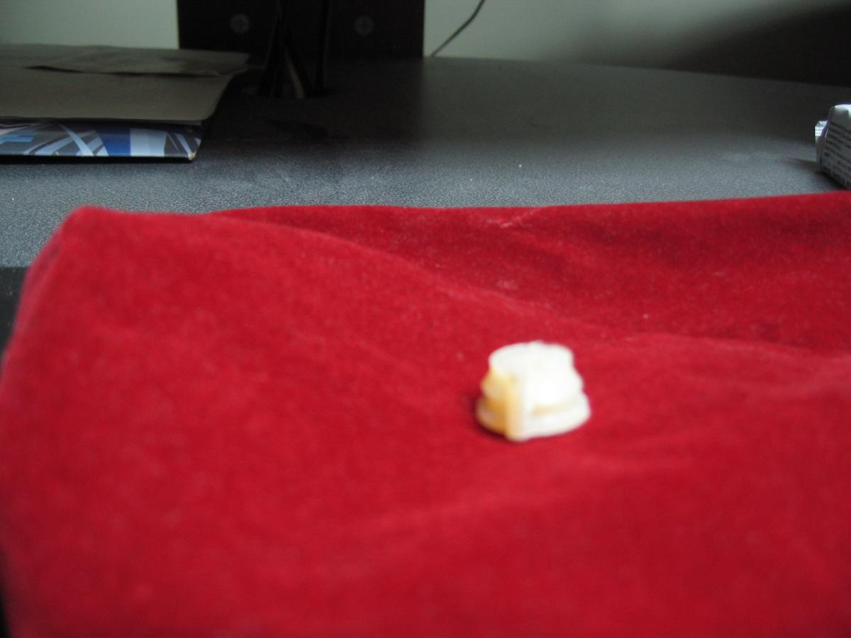

Has anyone else paid down on one of these? As of lately, they're not available anymore NOS. Not sure what may have happened to all of them, as of a year + ago, there was almost 200 of them in inventory. Now they're all gone.

Is there a reason you guys keep ignoring BigJim? He's offered several times to make this part and nobody responds. Its ******* rude. Hes not asking for any money up front (6 out of a needed 100 deposits? It aint happnin'. Get it?), just a sample part or even a drawing. If I had this piece on my car I would have sent it off MONTHS ago.

You can get the cream colored bushings from a Chrysler/Dodge dealer. The part #3799089. Cost around $2.00:confused3:
^^ what rdrunner 1974 said.. Bingo!!, I have a brand new bag of them that I just bought two weeks ago, same part number, not sure why but mine came in a bag of nine, I could not buy them individually. Bought right over the counter at my local Dodge dealer...
I found them all over the internet for very little money. I'm not sure what the issue is unless there are a variety of them and some are more difficult to find than others.

It's amazing to me how many people in this thread need to clean their glasses or get their vision checked or put down the pipe or something. Look very carefully at the nice, clear, sharp photograph in the first post in this thread. This what you're looking at is NOT the commonly-available snap-in bushing. It is the 3-piece release cam and pivot assembly that goes between the wiper motor crank arm and the wiper transmission drive bar. There is no aftermarket availability and there is no substitute, and no you did not find it at the dealer, and no you did not find it in the HELP! section of the parts store. Use your eyes, folks. :roll:

It's been said before on this forum that the old style link with the spring clip, wave washer, and black boot covered one should work. I see no reason why it shouldn't. The Coronet was the same body, same windshield, etc. Even the 3 speed link is shaped the same. It uses the small bushing and a regular old style crank but I'm sure it will not park the wipers below the hood. Still better than no wipers or using fishing line.

Just wondering the symptoms of the bushing failing? My wipers just stopped working, motor still works but just cant quite grab the wiper. I can hear it banging around and the wiper arms just do a little jump when I activate the switch. I'm scared to take it apart, probably won't like what I see lol
Also before it happened when I would turn off the wipers they would drop way below their normal sitting point and make a loud thump when doing so.
Yep, sounds like the classic drop. You should be able now to move your wipers by hand with ease. Take one of the cowl grilles off and turn on the motor. Now maybe you lost the small one since you can hear a thumping, which is the arm moving around.

Gents, my apologies if I mislead anyone here regarding this part issue. That was not my intention, rather the opposite, just trying to help. After seeing the picture at the start of the thread I thought that it was a linkage bushing that was the topic, as stated in the title of the thread.
Turns out I was wrong and should have looked a little closer. Just so happens that I just went through the same thing with my '70 and thought I could help. The guys at the parts desk told me these bushings will work for anything from late 60's to 94. As you can see from my pic; sorry not a good one, that I was thinking that we were talking about the same thing.
So I gather you were meaning the drive coupler for the wiper motor?
