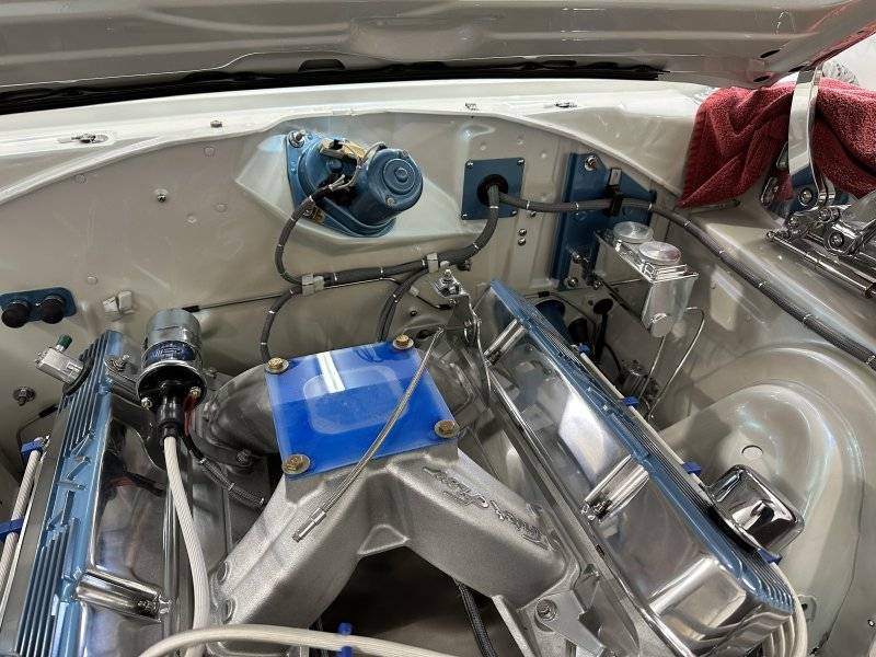

PLug and play stuff is usually OE stuff. And the easiest to install. Aftermarket harnesses have a lot of work that needs to be done to them. Sure they have extra circuits for AC and stuff like that. But trying to retrofit and use factory gauges and lighting etc etc its a pain in the butt. More time making connections to old sockets and plugs. The time is better spent elsewhere. Holley Sniper 2 has a pretty cool little panel that you can get for making connections under the hood like Electric fans, Sniper, Hyper spark and whatever else you want to add. In my opinion OE is perfectly fine and less time consuming and then add what you want to it.
I went with a Painless 21 circuit on my resent 68 RR build. PN 10127. Customizable. Pretty simple and straight forward if you know how to read and have a basic understanding of 12V DC power.
Having my original harness and wiring diagram available made it handy to sort out. The quality of the wire is superior. You can take a torch to it and it only gets black. No melt, no catching on fire. Plus it eliminates the fire prone bulk head connector. Does not look stock if that's your goal. I suppose you could incorporate one though. Much cleaner IMO.
Painless Performance 10127 Painless Performance 21-Circuit Mopar Color-Coded Universal Wiring Harnesses | Summit Racing

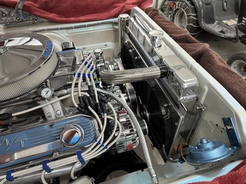

Electric Cooling Fans? Yes, dual 16" SPALs.
Alternator type, output and regulator type? 165 amp Power Master alternator with internal regulator. (Chrome :) )
Alternator pulley ratio and max engine RPM if known? No idea on pulley ratio, my 500" stroker taps out at 5,800 rpm. Rev limiter set to 6,100 rpm. 620 HP / 700 pounds of torque at peak rpm.

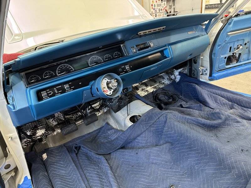

Stock dash switches and lights or custom? Stock dash switches. LED lights throughout the car.

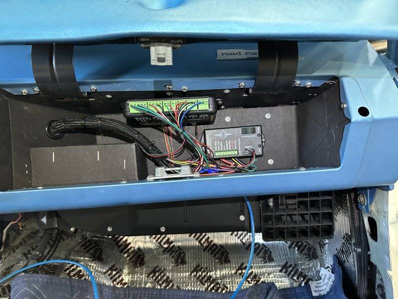

Which Dakota Digital cluster VHX-68D-STD-K-B plus the PAC-2800BT fan controller.

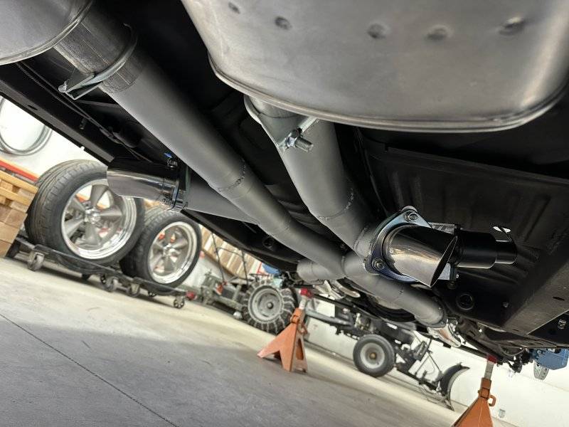

Other accessories? Electric trunk popper, electric in tank fuel pump, electric cut outs, Hurst roll control, built in Schumacher 5 amp trickle charger/maintainer.

The Alternator and pulley ratio question is to check if running underdrive (small crank) pulley that could hurt low rpm output from the alternator, and on the other side, you need to make sure not to over rev the alternator at high RPM. The 500" stroker (499" 4.15 stroked 4.375" 400 block) in the Charger I have the redline set at 7,000. At a 2:1 pulley ratio, the alternator can hit 14,000 RPM.
Dual 16" cooling fans is impressive to fit to the radiator size.
Does the alternator output just tie into the battery supply cable? or would the disconnect kill the engine if it was running?

The alternator is a one wire unit. The negative disconnect can't be touched while driving. It's in the trunk. The shiny box to the right with the key in it in the pic above.
I have a ton of wire left over from the Painless kit. Re-purposed much of it to the additional accessories, still have plenty left over. Great quality wire.
