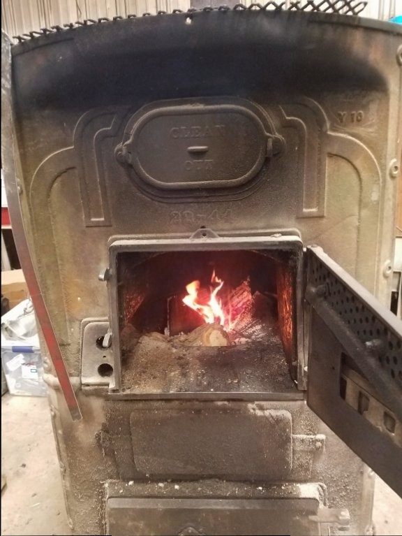

Here's my shop heater. It's a cast iron coal stove, although we burn wood in it. Manufactured approx. in 1900 by Excelsior Furnace of Chicago. Purchased at an auction around 1980, it has heated our shop since. Probably a bit primitive for the liking of most, it will heat our 60×40×16 shop to 70° in the coldest of winter days. With a home engineered squirrel cage fan behind it and a large ceiling fan above it. It has a fire in it from mid Dec until mid March. I burn mainly oak, mulberry, Ash, walnut, Elm in it, it smells wonderful.
They don't make things like the use to
We heated our home when I was a kid with coal furnace a lot like that, good furnace.
