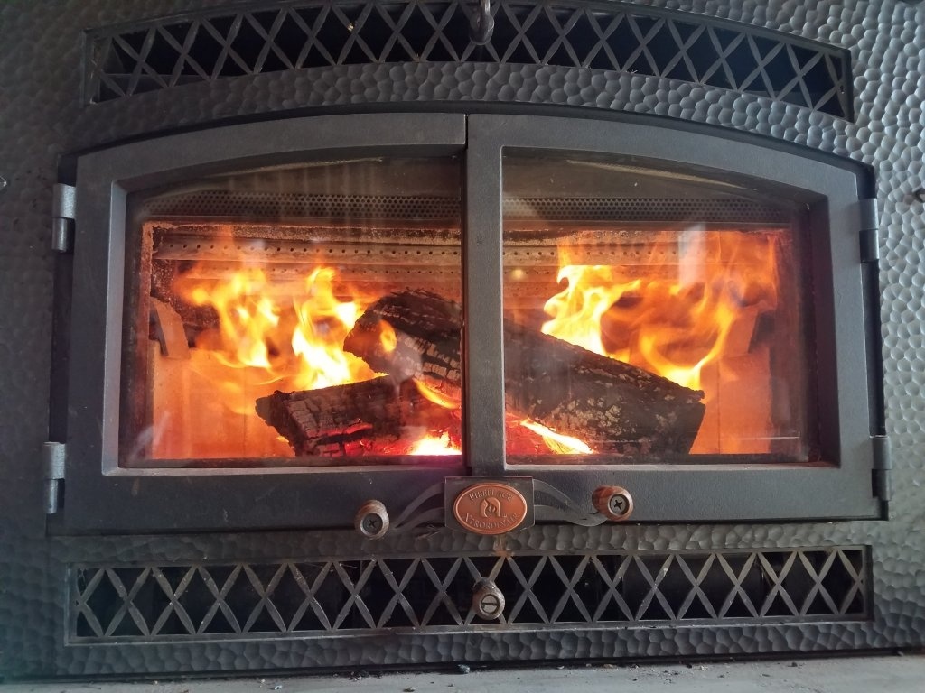

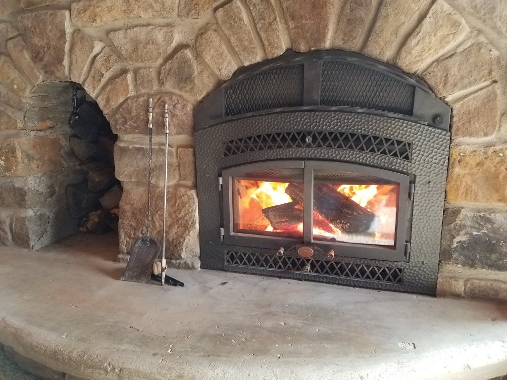

Here's a couple pics of what I have in the house and really like. Very simple and after 12-13 years I've only replaced the door seals, a couple bricks (I broke) and cleaned up and lubed the blower motors. This was advertised as a very clean unit, seldomly will you see any smoke coming out of the chimney and it heats very well especially given it's size.

Are we referring to the house? It's got glass doors and is surounded in concrete. Our insurance company doesn't like fireplaces but doesn't mind woodburners (fully enclosed) like we have.

6) That's a beautiful installation of your Lopi Fireplace Xtrordenair. I installed a lot of those and they are great heaters.
