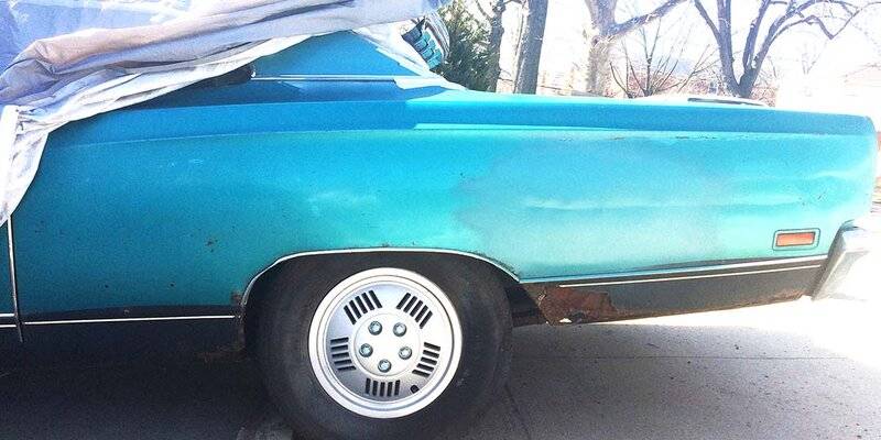

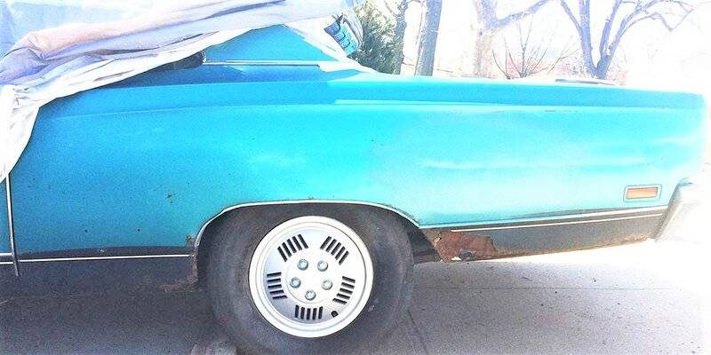

Highly optioned 69 GTX. Im concerned with hurting the value. Trying to decide to replace the whole quarter panel or do the lowers and a few small patches. Window corners and trunk channel would also need work.
Turn the car around and get the sun on it so we can see better, I can't even see what's bad in the front it's so dark? Some closer pics would help to. Good Luck
Cant spin it, not running. Front of quarter has about 6 inches of rust. I tried to lighten the picture.

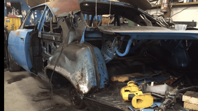

Just my two cents but: rust is like an iceberg, there’s always more that you can’t see. If you gotta do window corners and trunk channel there has to be more. I’d do the whole quarter rather then fix small areas then have more pop through later. My car was in even better shape then that, once we got into it we ended up doing quarters, back window and trunk floor. But mine isn’t a collector car, just a driver.
Original metal fits best. The amount of work can end up the same. The trick is either doing the work yourself, or finding a shop competent enough that you can afford. The repo quarters can take a lot of work to get right.
how is the wheel well and trunk floor? back window area good? That is going to be your answer. To me it looks like I would patch it.
Trunk floor is shot, wheels wheels are solid
It looks like it is rusting on the top of the wheel well? Less work and a better result hanging a new quarter I bet.

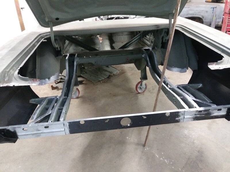

I had similar rust issues on my 69. And my upper area was nice just like in your picture. I bought both quarter skins thinking I would just replace them. But after inspection, I realized that I just needed to replace the lower front and back area and a couple of inches above the wheel well. I Decided to keep the marker light as the stamping on the replacement quarter was not as defined as the original. I replaced the trunk and trunk extensions as well.
Patch unless the wheel tub is chewed up. The floor can be done by itself as long as the drop offs are good i'd patch it. Depends on yer skill level or ability to pay for the work to be done.
Either job can be done well with appropriate effort. The full quarter effort will be in alignment, the patch effort will be in getting a weld that doesn’t show on the inside.
My saying is: "Where there's rust, there's more. " Rule of thumb is, retain as much original metal as possible. If those areas can be sectioned, with the remainder of the part solid, that would be the preference. Before proceeding either way, know EXACTLY how much is good, and how much is not. That will give you your answer.

Replace, then you have the opportunity to address what you can’t see. Save your #s that are stamped on the trunk gutter on the drivers side. Enjoy and take your time, it’s not that much trouble, new trunk Pans and 1/4 extensions. Piece of cake. Deck filler panel and corners at the bottom corners and you’re there, rust is gone.
Makes sense to do it all, this way I can address the hidden rust. Thanks
