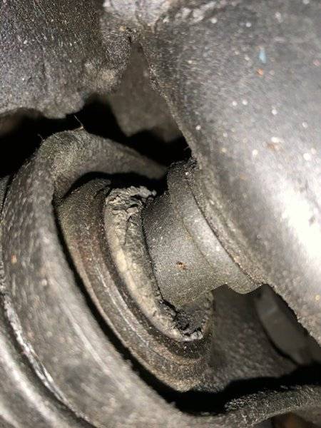

Excessive wear on the inside of one tire is an indicator of too much negative camber, either by mis-alignment or worn parts ( on Mopars, since the load is on the lower arm, the pivot bushing or the lower ball joint are the culprits).
Most of the old Mopars I've had liked to wear the upper control arm bushings.
That causes the same condition.
I've had several so bad, they were metal to metal.
as said, the front end needs some love with some fresh parts
I'm going to guess its the lower control arm pivot bushings are shot.
because that is usually the front end part that gets ignored the most..
when you have that kind of tire wear on the inside
that is usually the culprit..

flypaper, here is a pic of the LCA bushing..

at least you know where to start..
