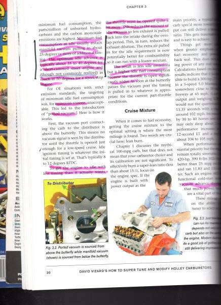

Does the xe 274 pull enough vacuume for my power brakes,me want more cam,I now have the 268 OK but I know it will work with more cam.built 360 30 over 9 2 1, 340 j with 202 valve, edelbrock rpm performer, Headman headers,650 VS. 323 gear, going with 355 next year.will this 274 work with my power brakes. Man I miss my old 69 dart 360 with 3
280 474 purple love watching my Cindy tits shake. At idle.lol
Should be ok provided you use a lot of initial [ idle ] timing to increase vacuum. See below
