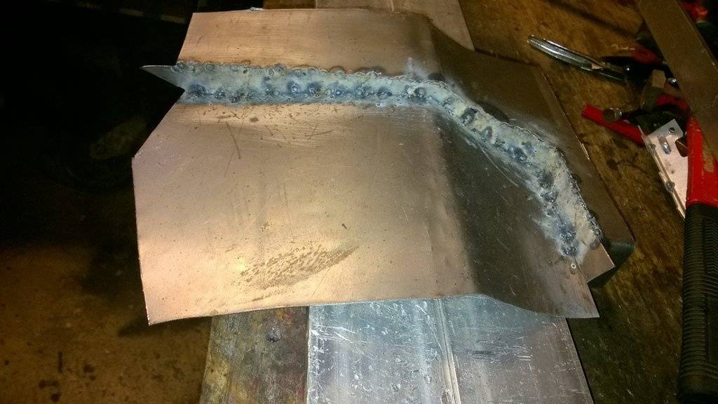

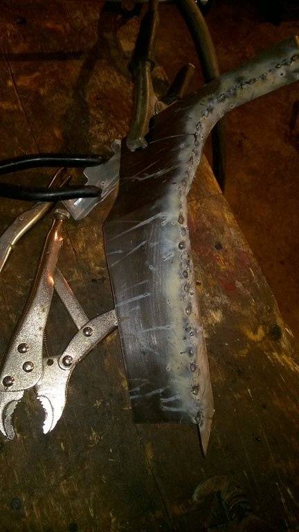

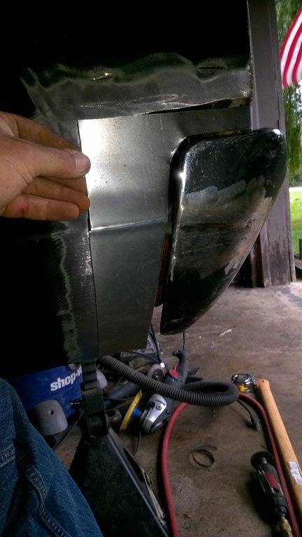

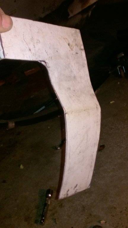

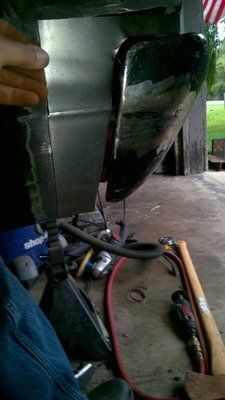

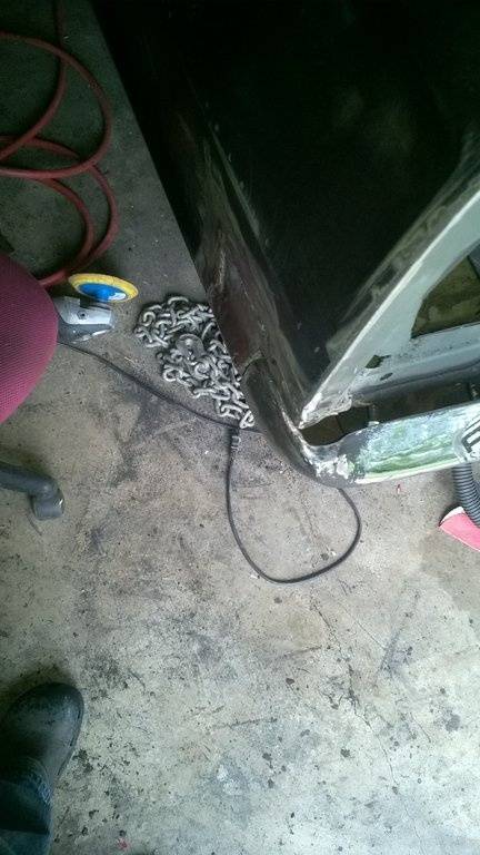

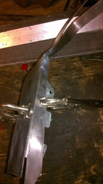

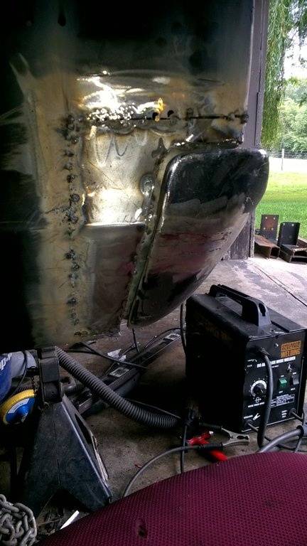

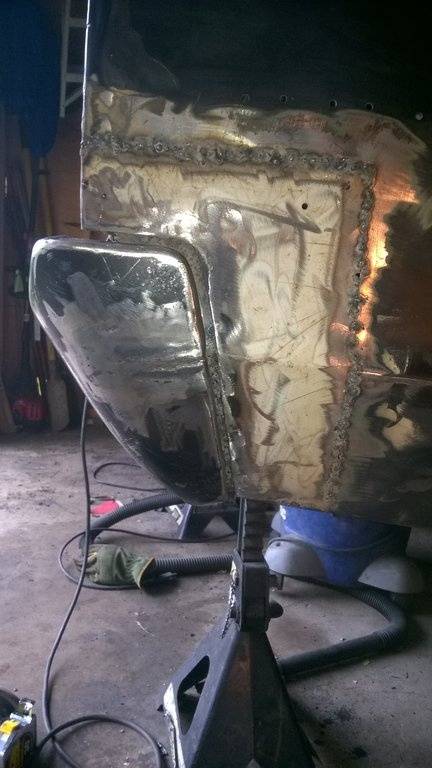

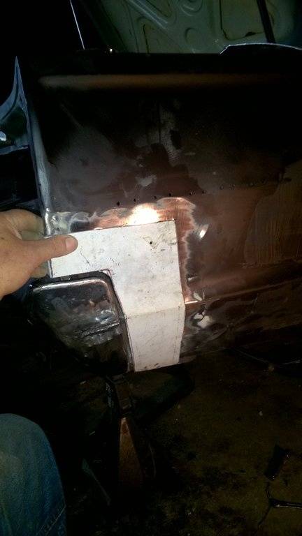

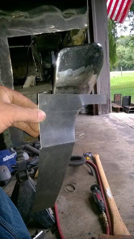

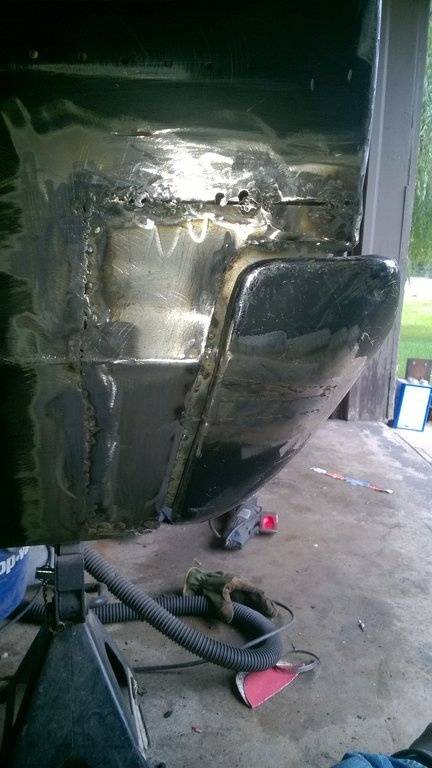

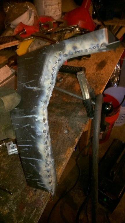

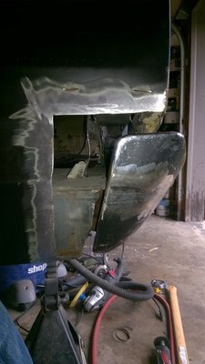

Well, I finally got disgusted with the way it was going on the bumper and sliced out the rear section of the quarter. Took a lot of measurements and made some cardboard( pizza box) templates and cut up some sheet metal. I turned out ok, not great,but ok. Need to grind it off still...
WP_20170904_19_30_18_Pro.jpg WP_20170905_11_30_21_Pro.jpg WP_20170905_11_30_38_Pro.jpg WP_20170905_11_30_42_Pro.jpg WP_20170905_11_30_45_Pro.jpg WP_20170905_12_01_54_Pro.jpg WP_20170905_12_13_52_Pro.jpg WP_20170905_12_14_14_Pro.jpg WP_20170905_12_30_59_Pro.jpg

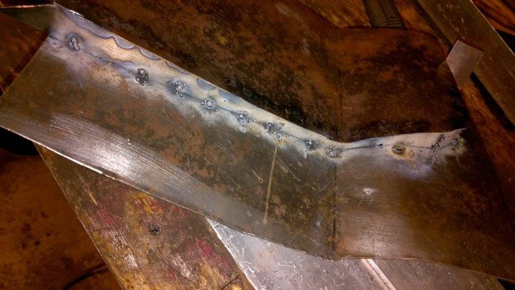

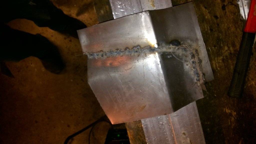

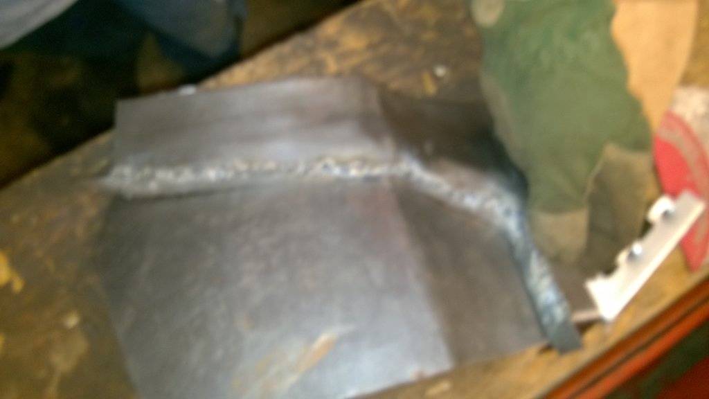

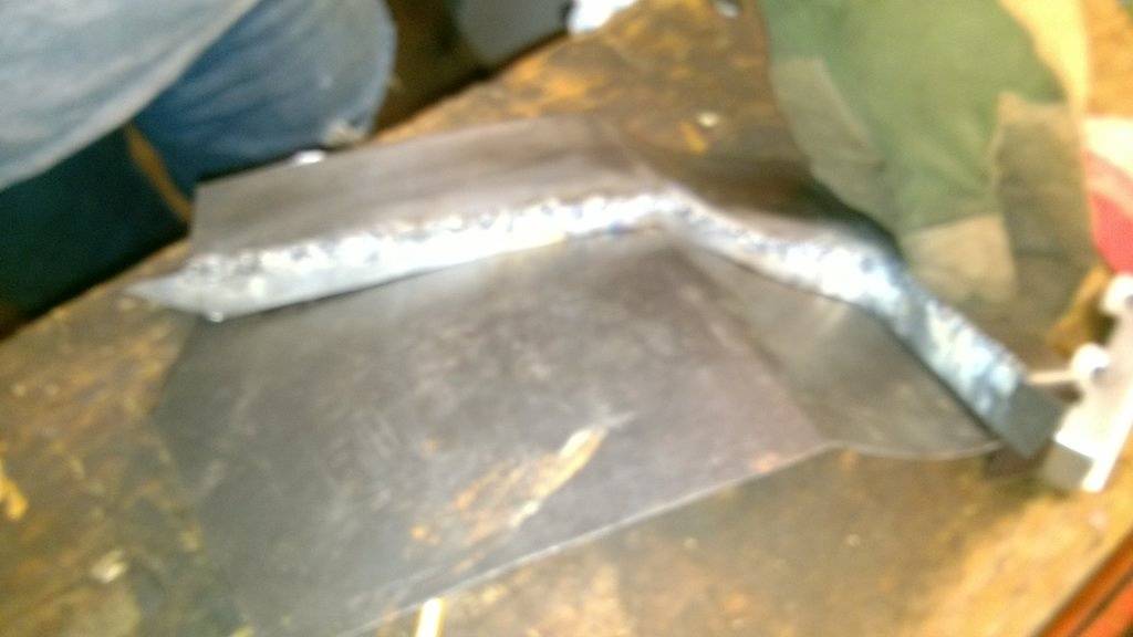

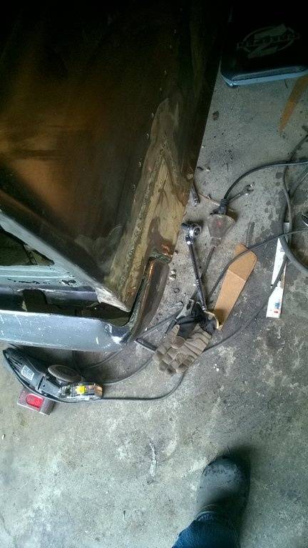

OKay...NOW..i'm happy. Forgot about the remainder of the left front fender I had for the nose section, I cut the new section for the right rear from it and it is pre bent exactly right! On this side I learned and welded it from the inside out...heh,heh. So both sides are done and they don't exactly match but that's okay because nobody can see both sides at once anyway.
WP_20170906_13_34_56_Pro.jpg WP_20170905_12_38_24_Pro.jpg WP_20170905_12_38_39_Pro.jpg WP_20170905_12_38_44_Pro.jpg WP_20170905_16_00_33_Pro.jpg WP_20170906_11_33_23_Pro.jpg WP_20170906_11_33_58_Pro.jpg WP_20170906_13_34_05_Pro.jpg WP_20170906_13_34_30_Pro.jpg WP_20170906_13_34_47_Pro.jpg
I dropped by Mac Steel in Rutland today and had a chat with the machinist/ fabricator about the lower trunk panel for the Express. I had made one but it was two pieces welded in the center because my sheet metal brake is only 30 inches wide. The piece is 44 5/8ths". He has an 8 foot brake and said if I brought the metal I could use his brake anytime for free. So I went inside and bought an 8" x 48" piece of 20 gauge and had him cut it to length and I marked it up for bending and went to town. Turned out perfect! All in one piece. I also got a piece of the same 48"x 48" to cut the trunk floor piece out of. Should be the very last metalwork I have to do. I hope...
