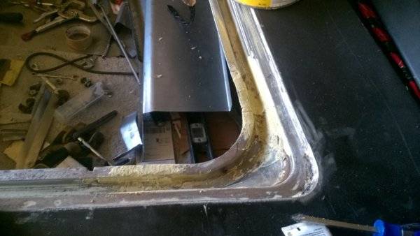

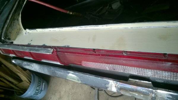

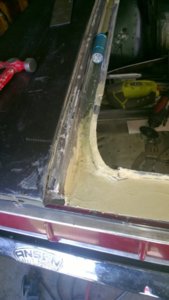

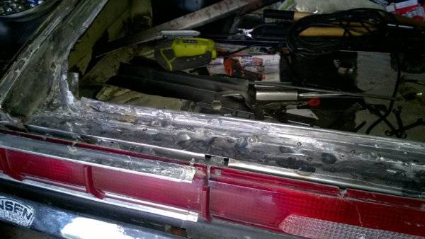

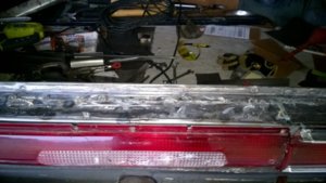

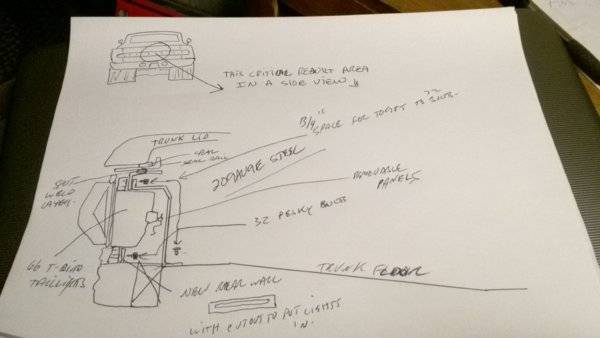

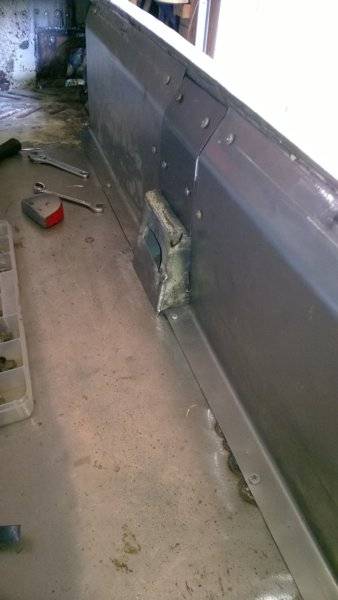

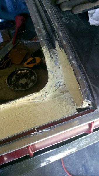

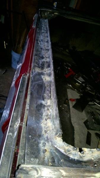

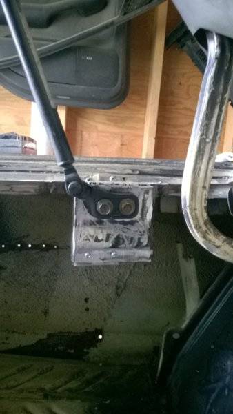

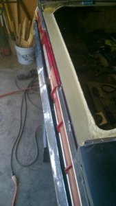

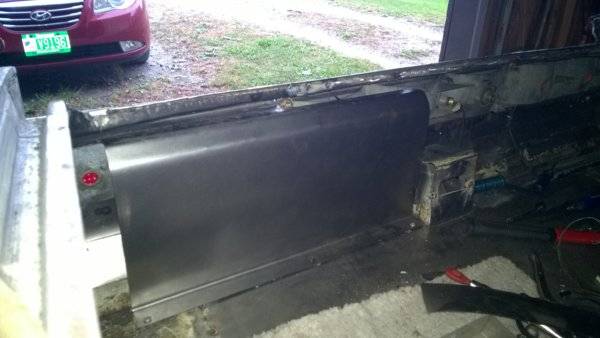

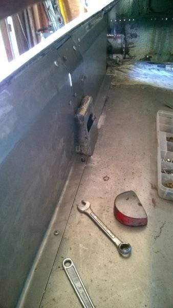

Today I finished welding in place the new design trunk seal rail. The design proved to be sound and is working as expected. Feels nice and solid and the 32 tail light mounting screws are easy to get to now. I still need to clean up some welds and place a nice flat strip of 18 gauge to close out the area just above the tail lights after which there will be a skim of filler to get it perfect. All of the welding was spot/plug welds except along the rail edge to the rear. A little tweaking still but it's looking good.
