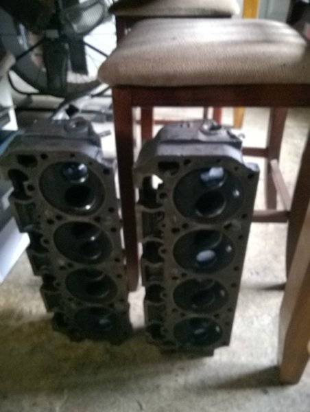

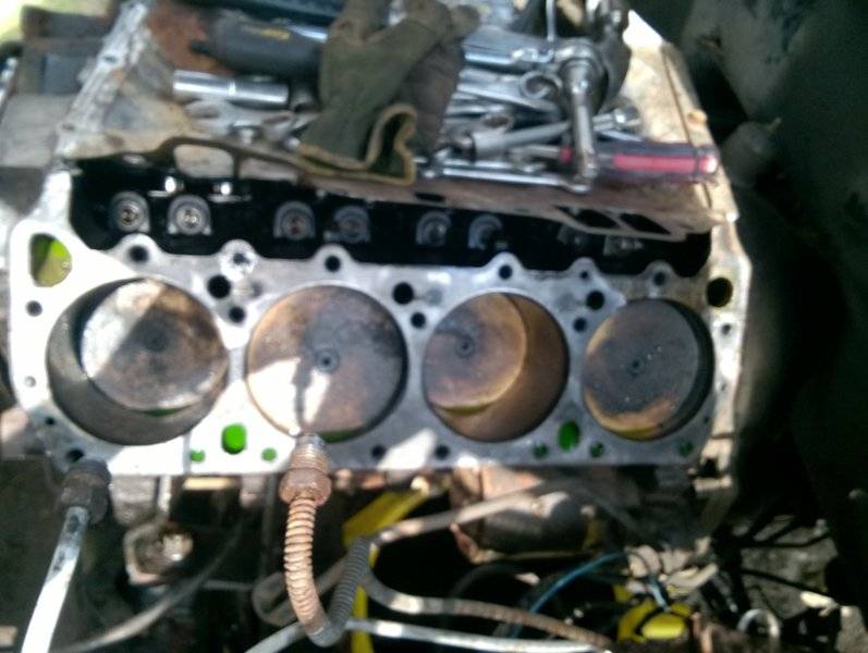

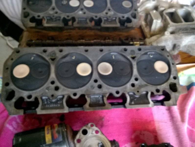

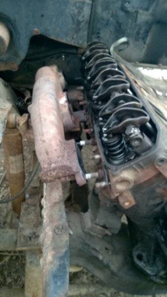

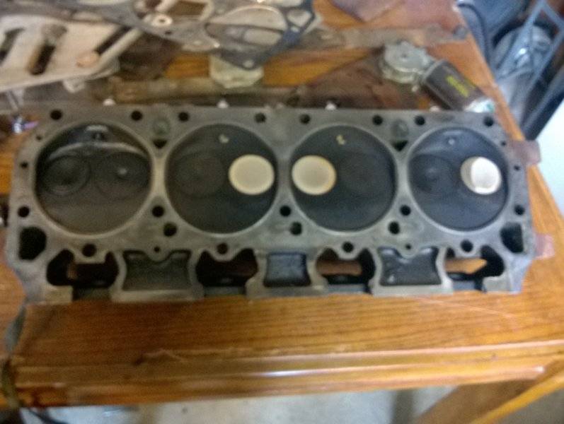

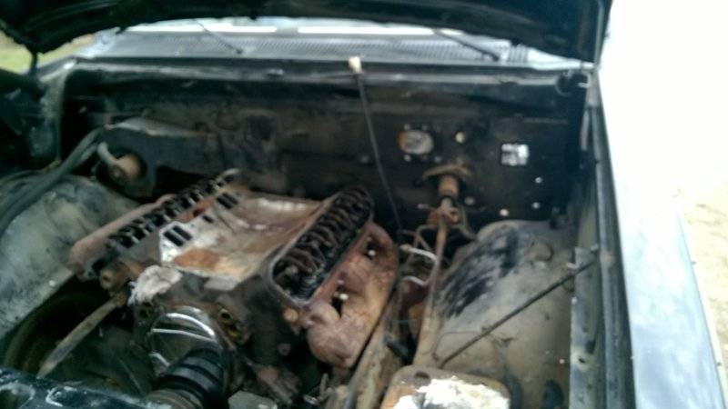

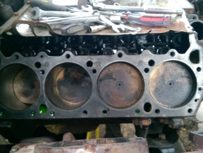

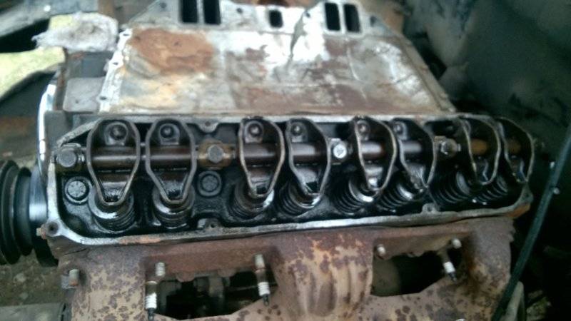

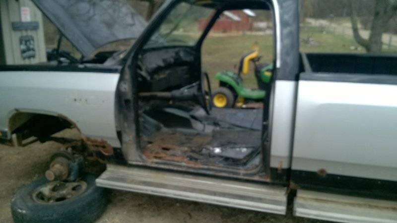

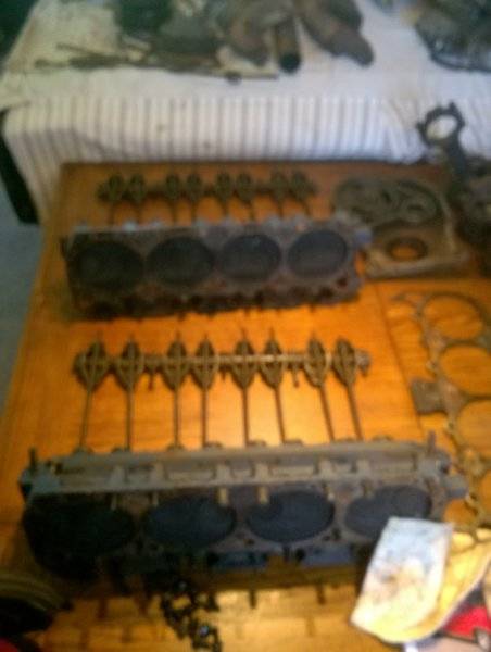

Thanks Roger! Got a bunch of good parts for the $ 700 bucks I paid for the truck. I intend to pull the heads and disassemble them, and then when I pull the block out I just have to lay it down in the truck bed and pull the bottom end and off it goes to be cleaned up.Making swift progress now Ghost....looking really good so far.![]()
Good, I know you miss being able to get at it..Nice days work, looking like I’ll have a chance to get out to the shop Friday night finally

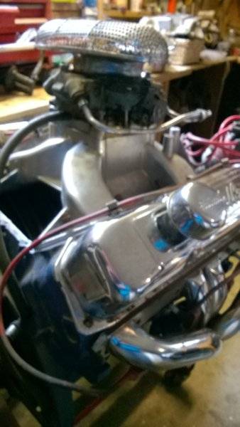

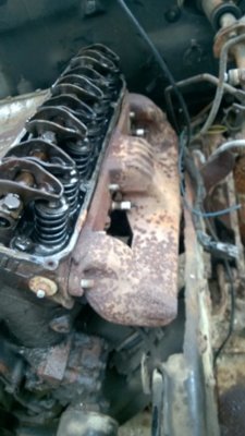

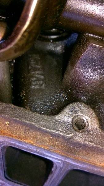

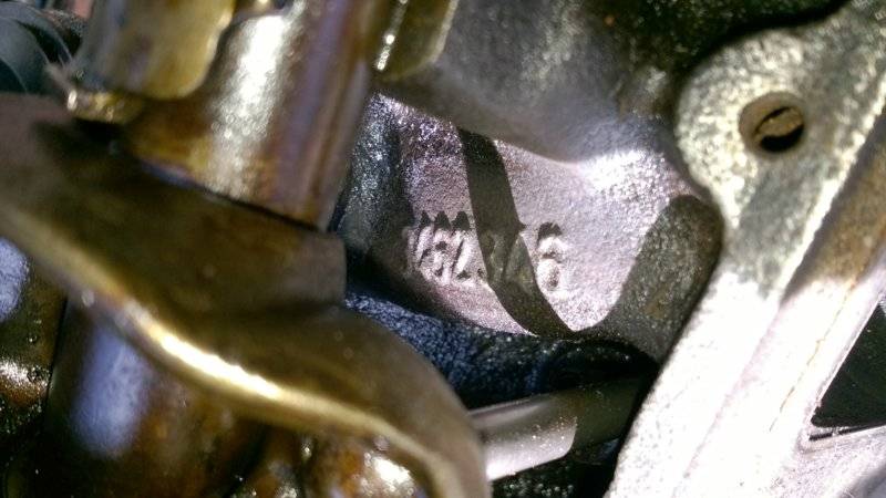

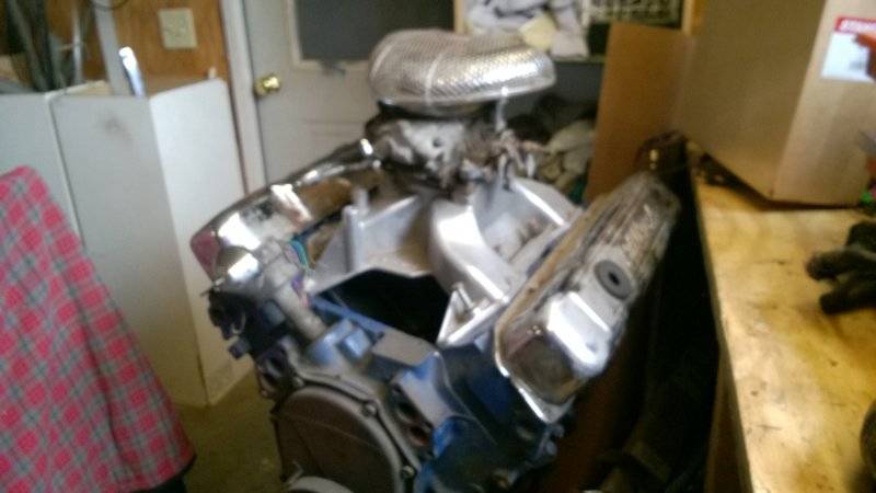

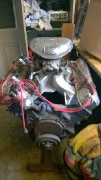

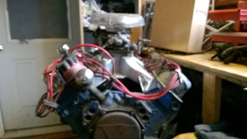

I'd get rid of that fire waiting to happen air cleaner...A mocked up look at the forthcoming power plant, just to get an idea, and motivation.....
View attachment 599078 View attachment 599079

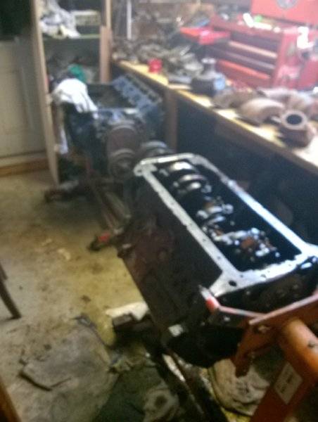

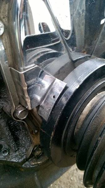

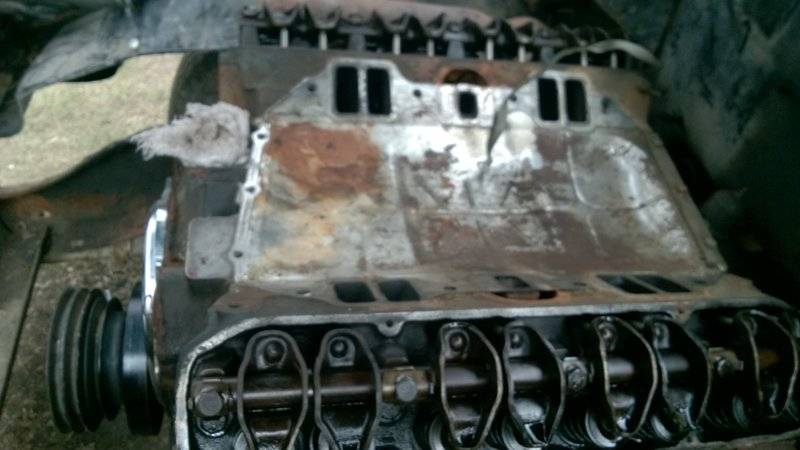

...Yeah, that IS one of the things I recall about engine work, clean it, then clean it three more times. It's the same with choppers, any little thing will cause them to fall out of the sky... I'm going to dip it into a 55 gallon drum and hook it up for electrolysis.. get the gun cleaning kit out and clean passages and all. I have nothing but time so I can afford to be thorough. I gotta see my pal Rick and see if he has a socket big enough to pull the crank bolt so I can get the balancer, pulley and timing gear off..Most likely pull the block out on Tuesday...I'd get rid of that fire waiting to happen air cleaner...
looking good Ghost

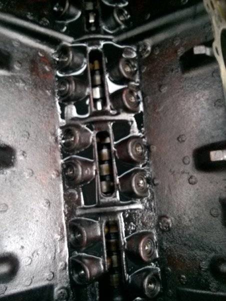

rebuild or RR time

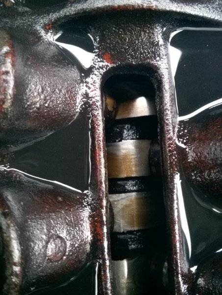

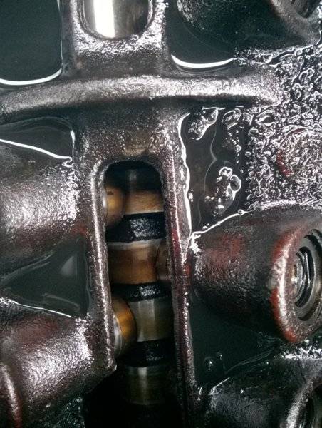

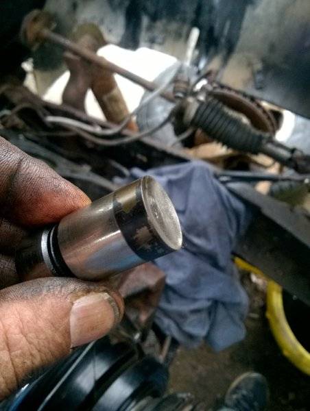

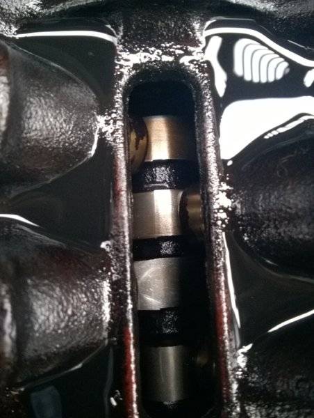

wiped out the camshaft/lifters
no biggie
you wanted a better camshaft anyway

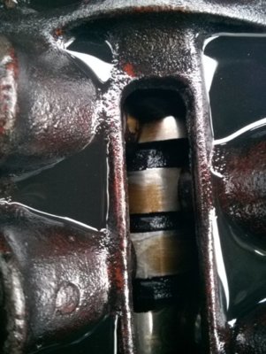

make sure to "completely disassemble the whole engine"
every nut & bolt & do the oil pump too,
make sure to "clean thoroughly/completely"
pistons & rings too, soap & water & hi-pressure air
getting all that crap out of all the oil passages & anywhere
pull all the oil passage plugs "make sure you get them all",
replace them after, clean out the rocker shafts really good too
"it's cheap insurance"
Heed the warnings;
It's all them little fine grindings go thru every oil passage
& every part of the engine {been there, done that}
OR
if you don't, it will wipe out the new cam & bearings,
not to say all the rest of the **** it could or will destroy...
good luck keep US posted
